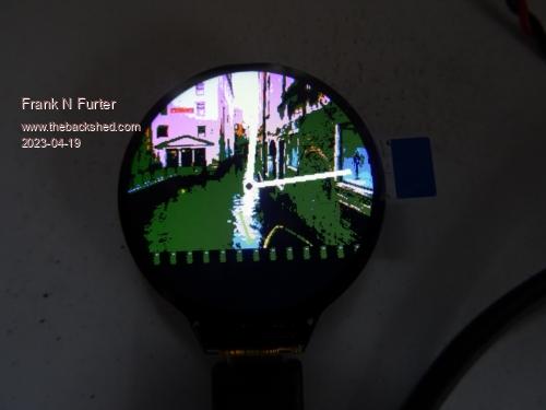

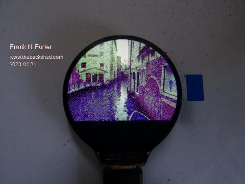

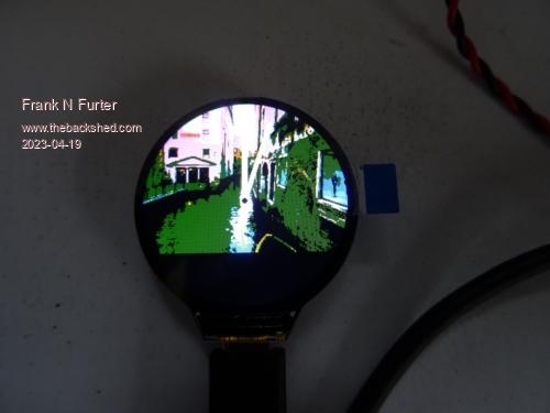

Hi,
I have tried the demo from Peter ( https://www.thebackshed.com/forum/ViewTopic.php?FID=16&TID=15427 ). Unfortunately, the background image is not included.
I have therefore experimented with my own images, unfortunately with only moderate success... Diese beiden Bilder zeigen mein Problem, hier die Originale:
DSC03042.zip
...and this is how the JPG looks like:
...and this is the BMP:

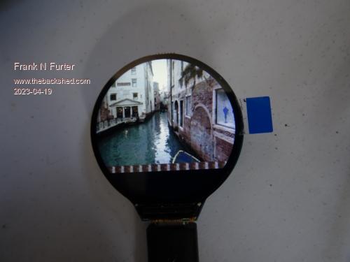

This is how it should look:
I have the current beta version - ? mm.ver says 5.07.07
What's going wrong here? I have tried other images, also with different image programs...
Frank

@Phil: With your program nothing happens at all on the display - the clock hands from the previous program are still shown...

Posted: 10:36am 19 Apr 2023
You haven't answered the question. If you are loading an image to a framebuffer or moving it to a framebuffer it is compressed to RGB121 - the same colour set as the PicoMiteVGA. To create a RGB121 image to your specification you would need to tell your photo program what the VGA palette is and get it to just use those colours but you are still limited to just the 16.
If you are not using the framebuffer then there may be a bug but please just reset the Pico and then load your image from the command line - nothing else - is it OK then?
My image is not useful. It is a greyscale image that I have manipulated and just has the dial markings

UPDATE: This behavior is reproducable! When I call LOAD JPG without FILES in front of it, nothing happens - no other image, just nothing at all!
But if I call FILES before, every time after LOAD JPG the "Invalid address" error comes. After the reset I can load the image correctly.
When I then start the program, it looks again like the pictures at the top.

The colour counter only uses a single pixel, so that is why you didn't see anything on the screen.
On the console you should see something like this:-
> RUN
 64 Blues
 64 Greens
 64 Reds
or this:-
> RUN
 32 Blues
 64 Greens
 32 Reds
Something is wrong if you get this:-
> RUN
 1 Blues
 2 Greens
 1 Reds
However you needn't bother as your last photo shows the display is working properly.

Posted: 12:58pm 19 Apr 2023
The Image has more Colors than the Pico can display
Here is an Online Ditherer, where you can save (copy and Past) a Custom Color Palette and it dithers in many different ways:

  Quote  The Image has more Colors than the Pico can display
I don't think so - the image is displayed properly after the RESET.

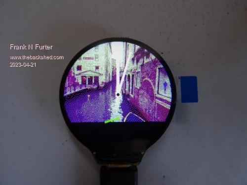

If I start your program, quit (CTRL-C) and call LOAD JPG "DSC03042", nothing happens. But if I type FILES before that and then LOAD JPG "DSC03042", the system crashes and reboots. If I then enter LOAD JPG "DSC03042", the image is displayed correctly.
When I start the program again, the image is displayed incorrectly again. During this procedure, the OPTION AUTOSTART ON function was apparently also lost...
This is reproducible with RC4 and RC5 for me.

LIBRARY DELETE has no influence. At the lowest LOAD JPG call the image is displayed correctly, at the following RUN the image is wrong again.

Posted: 08:03am 20 Apr 2023
OK Let's go through this bit by bit
  Quote  If I start your program, quit (CTRL-C) and call LOAD JPG "DSC03042", nothing happens.
This is because the image is being written to a framebuffer and not the screen after you ctrl-C out of the program. Framebuffers need to be understood and treated with caution.
  Quote  But if I type FILES before that and then LOAD JPG "DSC03042", the system crashes and reboots.
This is a bug that I think I have found and fixed in RC6. Please let me know once posted
  Quote  When I start the program again, the image is displayed incorrectly again.
This is correct. The image is being compressed to RGB121 when copied into the framebuffer. The image will only ever show properly if loaded direct into the display itself.

Posted: 12:19pm 20 Apr 2023
Hi Martin,
I would use THIS as a pallette for "dither_it".
Green can be 0, 1/3, 2/3 or 1 (not 0, 1/4, 1/2, 1 as suggested above).
[{"hex":"#000000"},
{"hex":"#FF0000"},
{"hex":"#0000FF"},
{"hex":"#FF00FF"},
{"hex":"#005500"},
{"hex":"#FF5500"},
{"hex":"#0055FF"},
{"hex":"#FF55FF"},
{"hex":"#00AA00"},
{"hex":"#FFAA00"},
{"hex":"#00AAFF"},
{"hex":"#FFAAFF"},
{"hex":"#00FF00"},
{"hex":"#FFFF00"},
{"hex":"#00FFFF"},
{"hex":"#FFFFFF"}]
