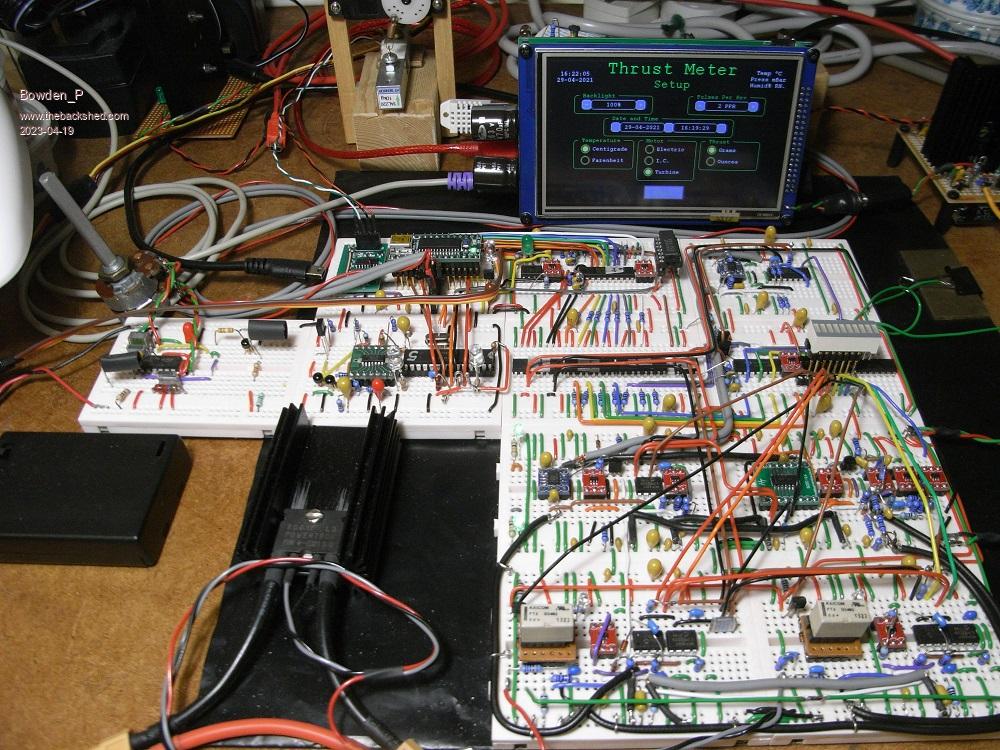

Just for your amusement - here is a picture of the overall project so far, and the front row schematic. It's all been through a few revisions to get here! All the green wires are ground links to ensure a good ground in this layout.

(That is quite a layout--good luck.)
