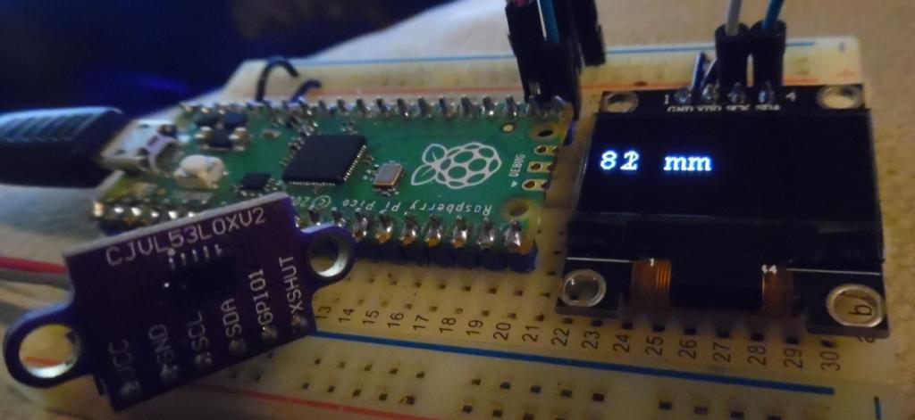

help me please. I want ssd1306 on i2c2 and other device on i2c. not a clue how to.
display works on i2c and device works on i2c with spi display but want i2c ssd1306 and i2c device to send data to ssd1306.

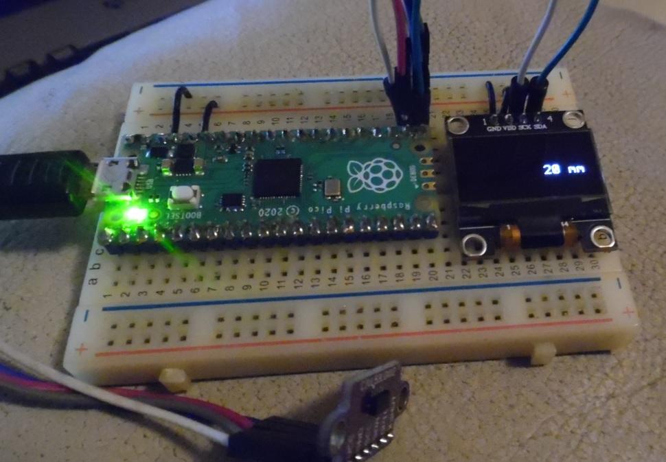

Thanks so much for helping me. option system i2c was needed. I had ssd1306 working... how I forgot... losing the thread :0)
The range finder and ssd1306 on same pins.
I2C is clearer now like spi display, touch and sd card share pins
but i2c uses addresses. You guys are stars, ta for help.

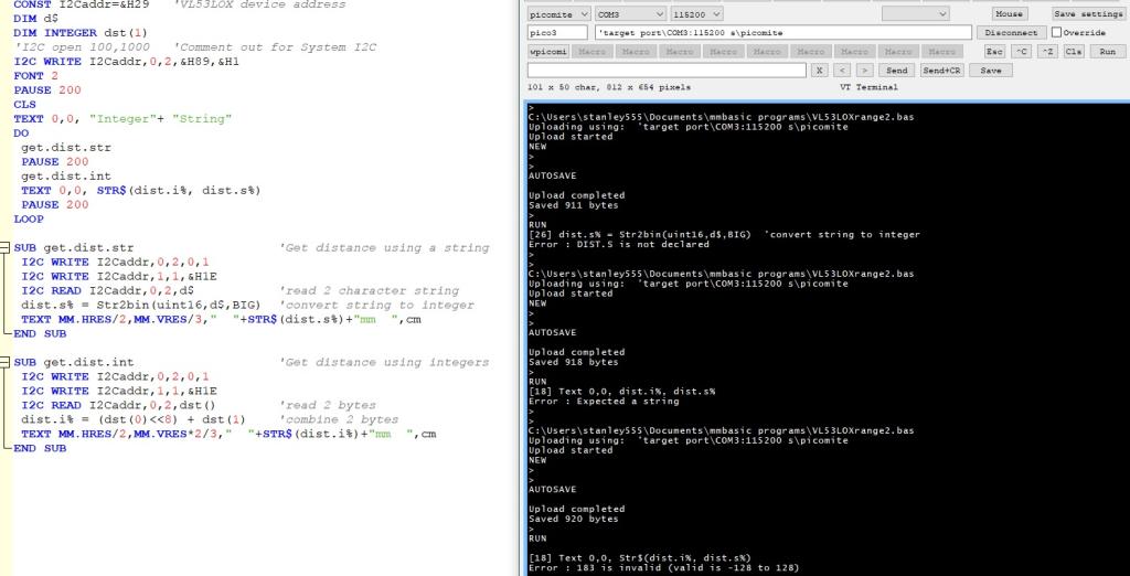

It is nice code by Matherp but how to get a variable like dist% from the code to use for like a theramin with dist% as the tone freq. I don't get d$.
how to get distance as integer var not d$? tried string$
It's a good range finder and should be an example imho

VAL(d$) might do what you want.
Posts: 6631
Posted: 09:08pm 14 Apr 2023
x = Str2bin(uint16,d$,BIG)
Posted: 07:48pm 15 Apr 2023
x = Str2bin(uint16,d$,BIG) converts it to an integer var. Thanks.
