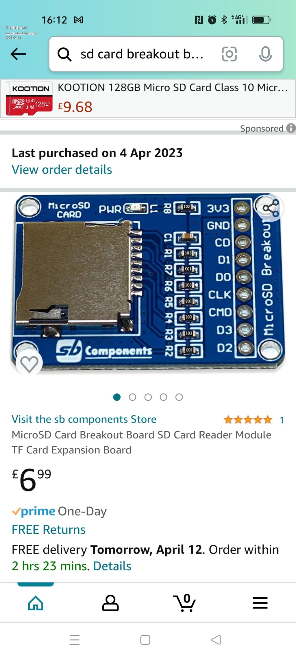

a no-name breakout board from Amazon - to the Picomite
Does the breakout have components on it? There shouldn't be any. Many of them are designed for level changing 5V to 3.3V for Arduino and are not suitable.

Yes indeed it does - a bunch of tiny surface mount components which may be resistors. And the Voltage in pin is labelled 3.3V. is that the wrong thing? I thought that the Pico operated on 3.3v?

This is the one I have:

But first buzz out which resistors connect to these pins and whether they are series resistors or pullups. If pullups remove them. If series resistors remove and replace with a solder blob. They look like pullups so R1-R7 can all be removed. Pullups are used for SDIO connection (and for this they are even the wrong value). They should not be used for SPI connections

It looks to me as if it should work, in theory. Those resistors look like 10k pullups. Additionally there's a supply bypass capacitor and a 1k/LED across the supply.
As a matter of interest, the micro SD card modules that I got from ebal also have 10k pullups - and they work. Maybe I'm just lucky?
I assume you are using the 3V3 supply from the PicoMite?. You could try adding a 2R2 series resistor then an electrolytic bypass capacitor of 10-47uF. Normally we don't need to filter the supply for micro SD cards.

It looks like this card is designed to work with 3.3V micros and the Raspberry Pi Pico in particular.
See this reference: https://learn.sb-components.co.uk/MicroSD-Breakout
So the problem is not with the breakout card.
It would be best to do as Peter suggested...
