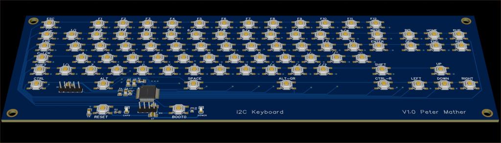

Posts: 11787
Posted: 09:49pm 10 Apr 2023
GBP 18 fully built by JLC. Just need to write the code for the STM32.
210.82 mm * 66.04 mm
Edited 2023-04-11 07:56 by matherp
Posts: 4395
Posted: 11:01pm 10 Apr 2023
ROFLOL, you're a "dangerous" man Peter.
The price is about twice what I originally paid for my M5Stack i2c keyboards, though it is also bigger; is that STM32 semi-unobtainium ? Could an RP2040 (running MMBasic ?) do the job. Or am I making sh*t up because I'm too ignorant to know better ?
Edited 2023-04-11 09:03 by thwill

Posts: 11787
Posted: 07:04am 11 Apr 2023
  Quote  is that STM32 semi-unobtainium ?
No, it is chosen because it is in stock at JLC and a "basic" part so minimum cost.
All the parts are "basic" for cost reasons
The GBP price of 36 for 2-off and includes shipping and VAT
The actual cost per board is just under GBP9
I intend to design a 3D printable overlay to turn it into a "real" keyboard
The problem with netbook keyboards is that there are no pinouts available, the pinout is probably not standardised, and they need a undefined FPC connector before you can even start to try and buzz them out to connect to a uP. After all that you can start to think about how to mount them in a usable way
Posts: 9086
Posted: 07:40am 11 Apr 2023
I like. :)
I like the two spiky sticky up finger piercers at the LH end too.  ;) (swap them for right-angle ones?)
I can see the 3D printer owners being in demand: "Hey, ..., How do you fancy swapping one of your keyboard overlays for one of my ready built keyboard PCBs?". :)
Posts: 11787
Posted: 08:04am 11 Apr 2023
The headers were just to create the holes in the PCB. The 5-pin one is the ICSP header for debug/development. The 4-pin is the actual I2C and could be right angle on the bottom or flying lead - whatever
Posts: 9086
Posted: 09:00am 11 Apr 2023
I thought it might be something like that.
