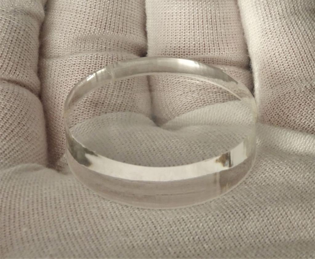

This image; my CO2 laser properly adjusted; compressed air coaxial to the beam; one centimetre thick acrylic.  One pass of the laser beam.
Acrylic cuts beautifully as you say. When I am making matching components for model making, that is where one fits inside the other, I find that I can cut the bits, try them against each other then make perhaps 50 or 100 micron adjustments to get the perfect fit.  The width of a cut made by a saw blade is called the 'kerf'.  The laser equivalent, that is the width of laser cut, is normally around 100 microns. Stepper motors are driving at 24 000 pulses per inch, hence the gloss finish.

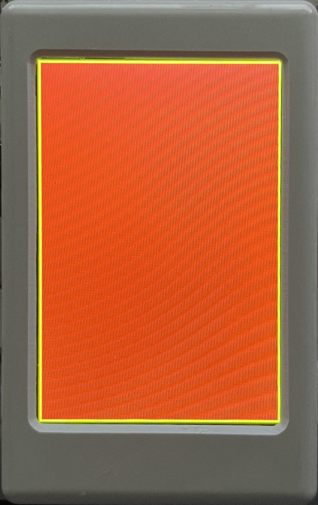

I am by no means an expert but I now have my 3018 CNC doing what I want with the white Polycarbonate wall plates.
The secret is the cutter, I tried many cheapo Chinese ones and had horrible results with melting etc.
I now use a high quality HSS upcut end mill that I buy from Adams Bits like this
Up cut for Plastic
The way i approach it is as fast a speed as I can get on X and Y axis (I set about 800mm/s) and no more than 0.2mm cutting depth per pass. This depth means the cuts take a reasonable time to make but I am very happy with the final results.
See my latest Blank wall plate (low profile type) with a 4" TFT (NOTE the herringbone is an artifact in my poor camera work, the screen looks perfect as you would expect.)
and
This is a long process to machine front and rear fascias and takes roughly 1 hour to complete both front and rear fascia.
I do the Vee groove after I have roughly cut out the inner hole so that the finish is smooth.
I am very happy with the result and the low profile fascias are (note were) dirt cheap at about $1.20 AU each but I just looked and they have nearly doubled.
Blank Low Profile wall Plates
