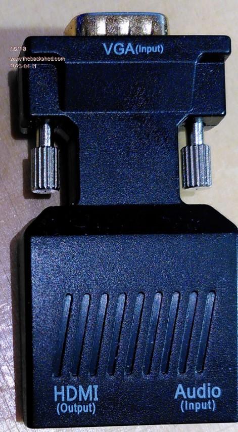

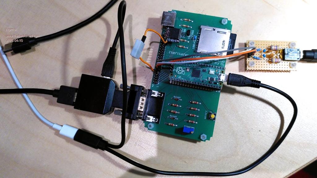

I bought this adapter here for 10 EUR from Amazon and the adapter works for me on the PicoMiteVGA with my monitor.
https://www.amazon.de/dp/B08SR7FCRM
However, since the adapter needs USB power, I connected the two devices with a USB-C Y-cable to USB-Micro ;-)

Hi MC999,
I have one that looks identical to the unit Homa showed above and it works well on the CMM2.

Yes the Amazon image is incorrect. But the delivered adapter has the correct labelling and an audio input! ;-)

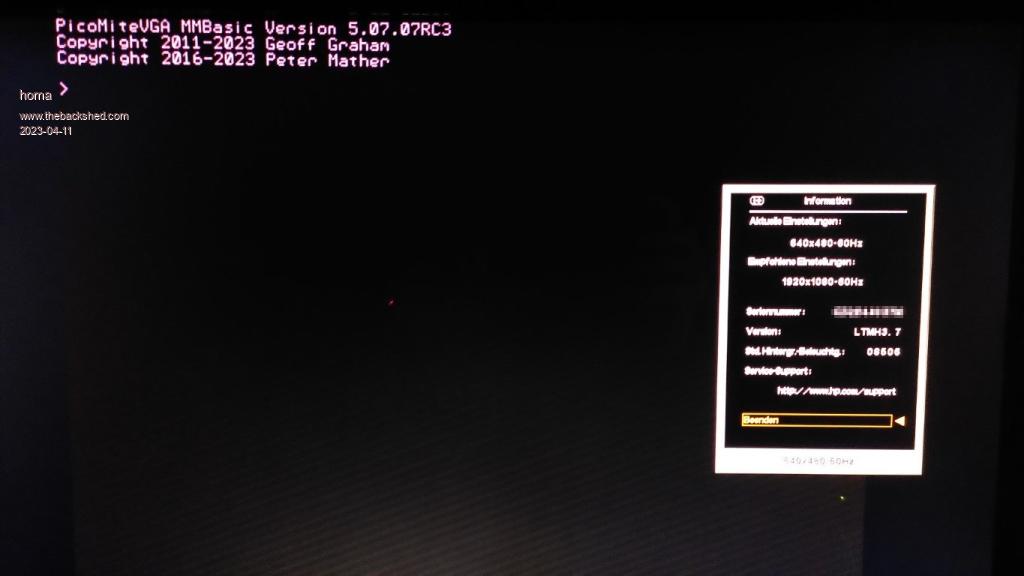

What screen mode is working?
Plasma
homa
Joined: 05/11/2021
Posts: 730
Posted: 09:39pm 10 Apr 2023
  Plasmamac said  What screen mode is working?
Both. Mode 1 and 2. Or do you mean the resolution on the monitor? See picture ... 640x480-60Hz
