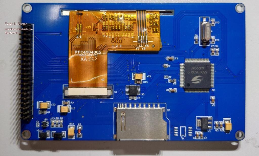

Perhaps be a little cautious about the orientation of the board; your image shows the circuit board overprint to be upside down.  It is unlikely that this board is intended to be in this orientation.  Perhaps the connector on your board is on the opposite side to the one shown by Peter.  Checking that the ground connection corresponds to the standard diagram might be sensible before making other connections. The connection is likely to be standard but which way up?

You are right! The orientation of the plug is unusual - that's why I asked here first. I have now ordered it - let's see if I can measure the pinout out...

Be aware that some SSD1963 boards have solder jumpers to select the operation of the backlight.  Yours has J1, J2, J3 jumpers which are apparently open.  These may have some functionality in backlight control.

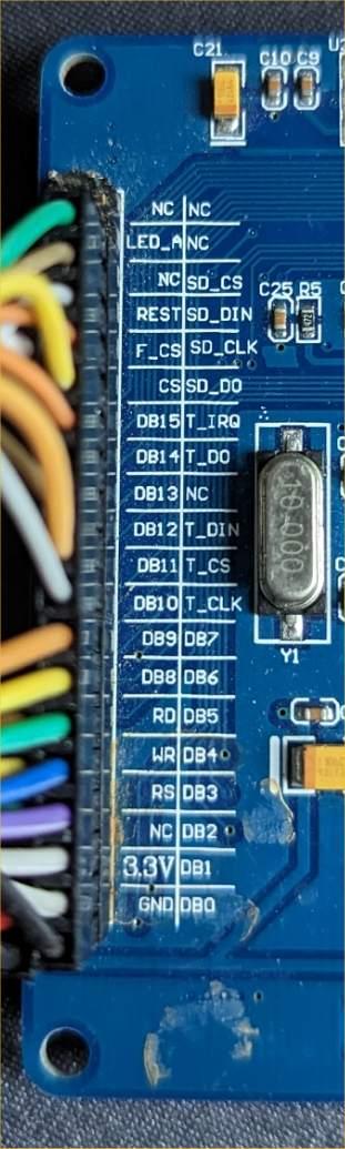

First realization: The display has a default assignment, as posted by Peter!
