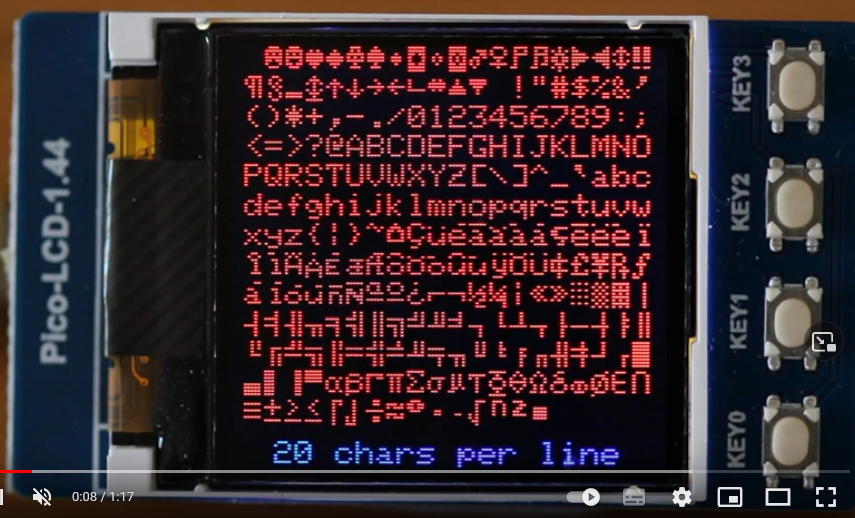

Thanks. I had this working for one character at a time using Chr$(xxx), but am puzzled as to how I can create larger graphics using the extended character set. Tony Goodhew from the UK has posted a Youtube video showing a text and graphics workout for the Waveshare 1.44 LCD running uPython on a RPi Pico:
I'm trying to find out how to do the same in MMBasic, but I haven't used basic since the early eighties. Fnd finding the Picomite project a few weeks ago has rekindled my interest.
I am using Tera Term VT on Win 11 to code my Picomite, and the embedded fonts folder in my PicoMite firmware download contained extra fonts, but no additional information.
Tony Goodhew's interesting video is here

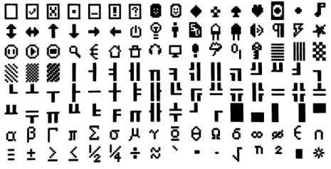

But the graphic characters (here from the manual) seem to be missing:

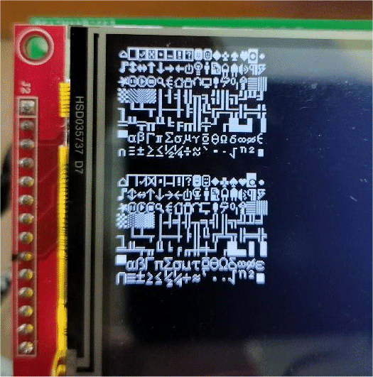

Posts: 3871
Posted: 01:28pm 29 Mar 2023
Works for me (ILI9488):
  Quote  PicoMite MMBasic Version 5.07.07b28
Copyright 2011-2023 Geoff Graham
Copyright 2016-2023 Peter Mather
> font 1
> cls
> fh=mm.fontheight:fw=mm.fontwidth
> for i=0 to 7:for j=0 to 15:text j*fw,i*fh,chr$(127+(i*16+j)):next:next
> font 4
> for i=0 to 7:for j=0 to 15:text j*fw,(i+9)*fh,chr$(127+(i*16+j)):next:next
Edited 2023-03-29 23:29 by lizby

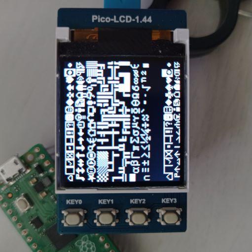

Many thanks lizby! I've just got it working. Using your code it's just what I was trying to do:
Martin - thanks for your suggestions. I was trying to use the buit-in fonts from the Picomite, and thanks to lizby I've got it working now. I'm not sure how my image somehow rotated 90° left, but shows the result.
