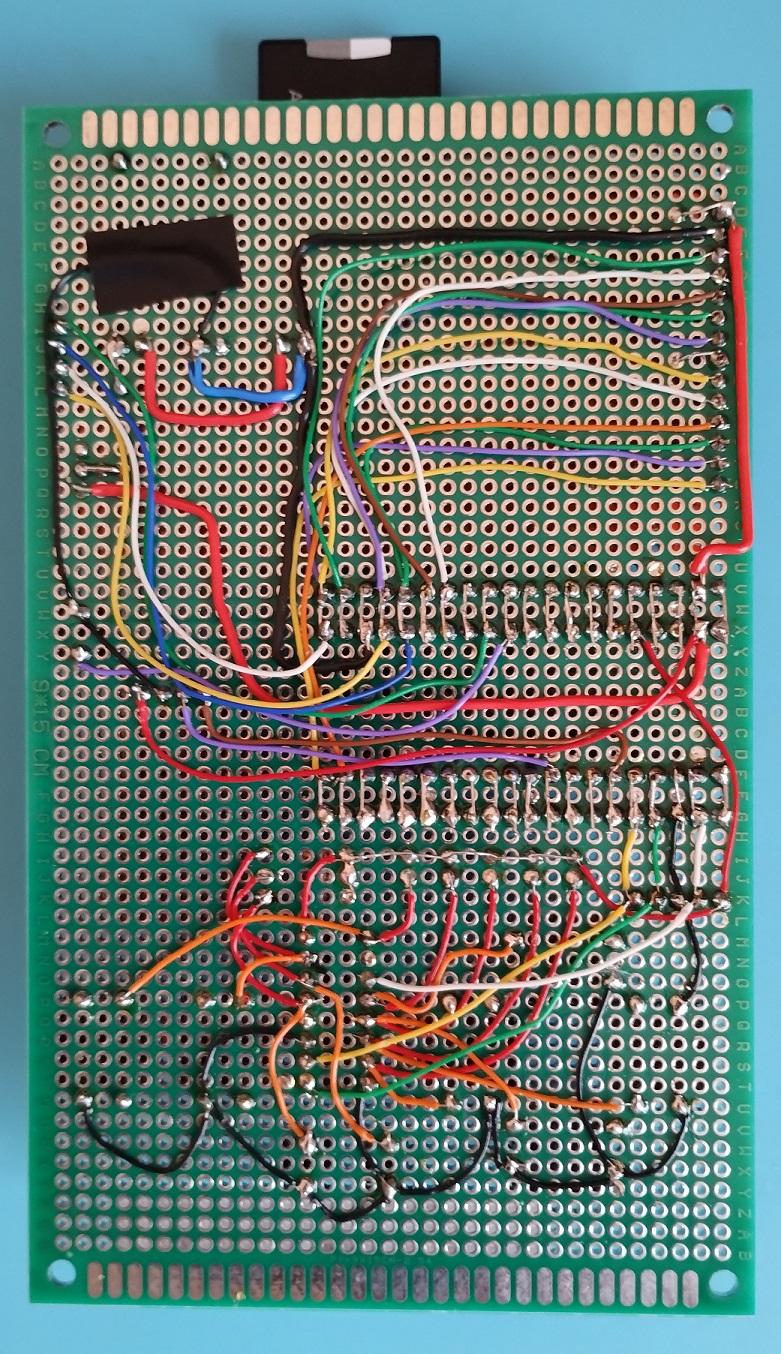

Then I see a contribution from Tom with his Pico bintendo.  Nice photos but he doesn't show his wire side.   . I'm curious how he did it.

  nbrok said  Then I see a contribution from Tom with his Pico bintendo.  Nice photos but he doesn't show his wire side.
Let's start with an obligatory "Not a Guru", I know nothing about electronic engineering in general or interference between signals specifically.
The PicoGAME LCD / Bintendo Tomboy is a complete lash-up without even the basic bypass/decoupling capacitors (except what is already present on the Pico and LiPo charging modules). This *may* explain the audio noise problems I am encountering .
I'm fairly certain I have posted this (now slightly out of date) photo before:
Note that the insulation tape is purely structural.
  Quote  I'm curious how he did it.
Beginner's luck ... or it's not that hard after all and some of the capacitor / routing voodoo, at least for hobby projects, is just superstition ?

First, you use thicker wires I see (I used wirewrap wires).
Second, your layout is so that your wires aren't that long (at 25MHz can that make the difference).
Also you can be lucky with the version of TFT you use. In my test three of the four I had didn't like the noise . On my definitive PCB design I have no problems at all, what I already mentioned.
So you where lucky, but for a beginner in electronics your work isn't that bad.

  nbrok said  First, you use thicker wires I see (I used wirewrap wires).
Most of them are 30 AWG, I thought that was wirewrap wire ?
I looked into wirewrap as an actual prototyping technique but the posts seemed to be expensive / difficult to come by. Likewise I've played with using wire with "solderable" insulation but found that it was not as solderable as it claimed to be. In the end I've settled on the approach shown whilst recognising it is a bit amateur.
Some of the power and ground wires are 23 AWG "hookup" wire, used more out of superstition than knowledge that thicker wire would be better.

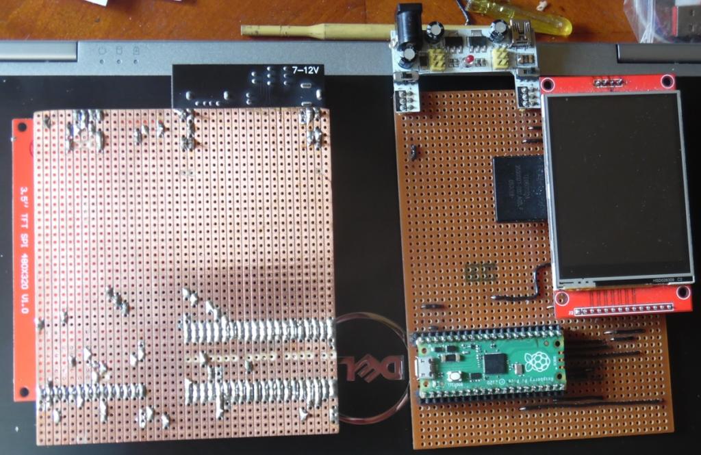

Posted: 03:06pm 27 Mar 2023
I've had no problems with spi touch lcd with sd card on strip board, maybe lucky.

  Quote  I've had no problems with spi touch lcd with sd card on strip board, maybe lucky.
That is much nicer wiring than using flying leads and effectively not much different than a PCB.
The only change I would make is to cut all the LCD tracks as close to the connecting wires as possible so there is the minimum track with the signals on them

I will cut the unused tracks as the capacitance between tracks could cause problems.
There's "vero" that looks like bread board but it costs more. Great for transferring bread board to something more reliable. I find bread board tracks too short ie not enough holes per track. I never got problems with bread board ...as long as you don't move it :)
"vero" has been around ages but I can't find a "spot face cutter" so use drill bits to cut tracks.
There's a pc vero designer, Veecad but it was easier to use pen and paper.
You can't use vero for a vga connector.

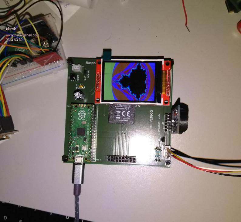

I just received my last pcb design from Aisler PCB service and here I have no problems with the LCD.
Here a photo:
