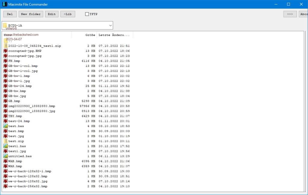

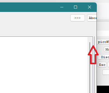

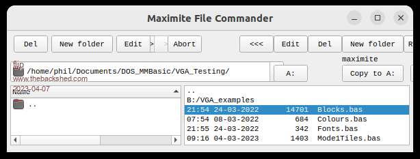

Posted: 05:33pm 06 Apr 2023
just installed V5.1.1, MMedit seems to work normal but with MMCC in filemanager mode i just see the PC files, not the files on the pico. File transfers from PC >>> pico work though.
This is how the filemanager windows looks like
Is there something i've done wrong?
Gerald
73 de OE1HGA, Gerald
Posts: 6631
Posted: 08:45pm 06 Apr 2023
Your slider has moved to the right. Move it back to the centre and the picomite files will be visible.
If it happens again, send me a copy of your mmcc.inf file before adjusting it so I can try and find out why it happened.

Posts: 137
Posted: 04:53am 07 Apr 2023
Hi Jim,

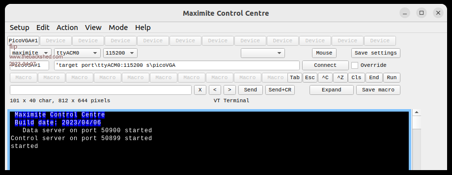

Thanks for your latest MMEdit...running well on my new Linux machine...back in the MM world after a hiatus of few years but still regularly reading forum.
(I had an issue on my Ubuntu 20.04 system caused by failed attempts at qt5 install which caused conflict - I removed them from 'Ubuntu Software' screen and all perfect..your instructions all good).
Just one problem with File Commander, looks like it's sending the first field (Time) instead of the file name.
> XMODEM SEND "07:54"
Error : The logical drive number is invalid
Maximum Errors. Transfer Aborted.
File transfer failed
Finished

Posts: 6631
Posted: 05:03am 07 Apr 2023
Phil,
What device are you connected to. You have it set to "maximite"
You must set the correct device before opening the file manager.

Thanks Jim,
I can see the problem (I think)
that maximite seems to come back whenever I exit and re-run MMCC
I can't make the picoVGA 'stick'
Phil
Edit...I guess 'Save settings' doesn't over-write  the .inf? ...I can easily edit...learning as I go.
OK Saved the change in the MMCC.inf file.
It now shows up as 'picoVGA' fine
But no difference to the problem...still trying to XMODEM SEND the time as a file
Phil
Edited 2023-04-07 15:28 by flip

thanks, moving the slider did it ... so easy. And it survived the last reboot, so seems to be just my fault. I apologize, but I just didn't see the slider on the far right.
Gerald

One thing I have learnt is that Windows (and Linux) can do strange unexpected things.
I have changed it so you can't slide it all the way over. That way users can see what to do.
