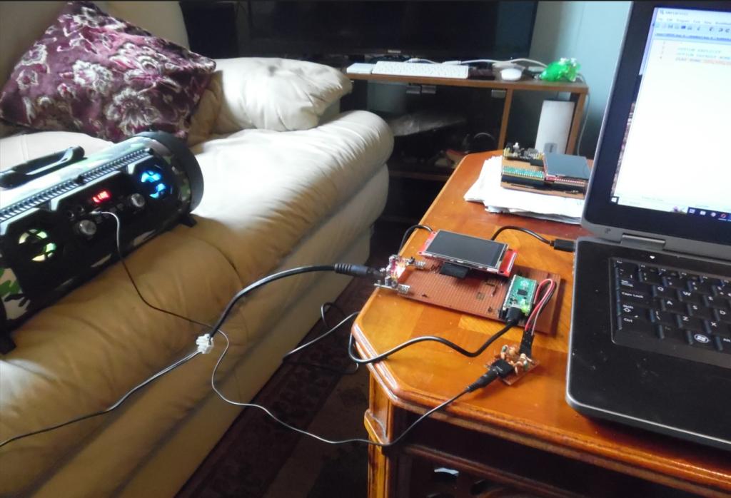

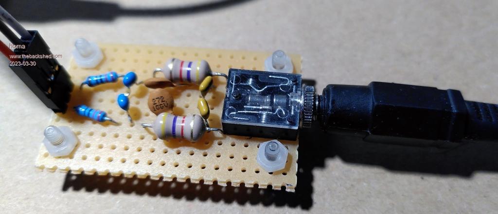

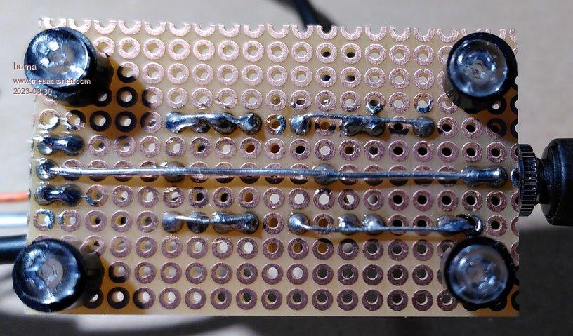

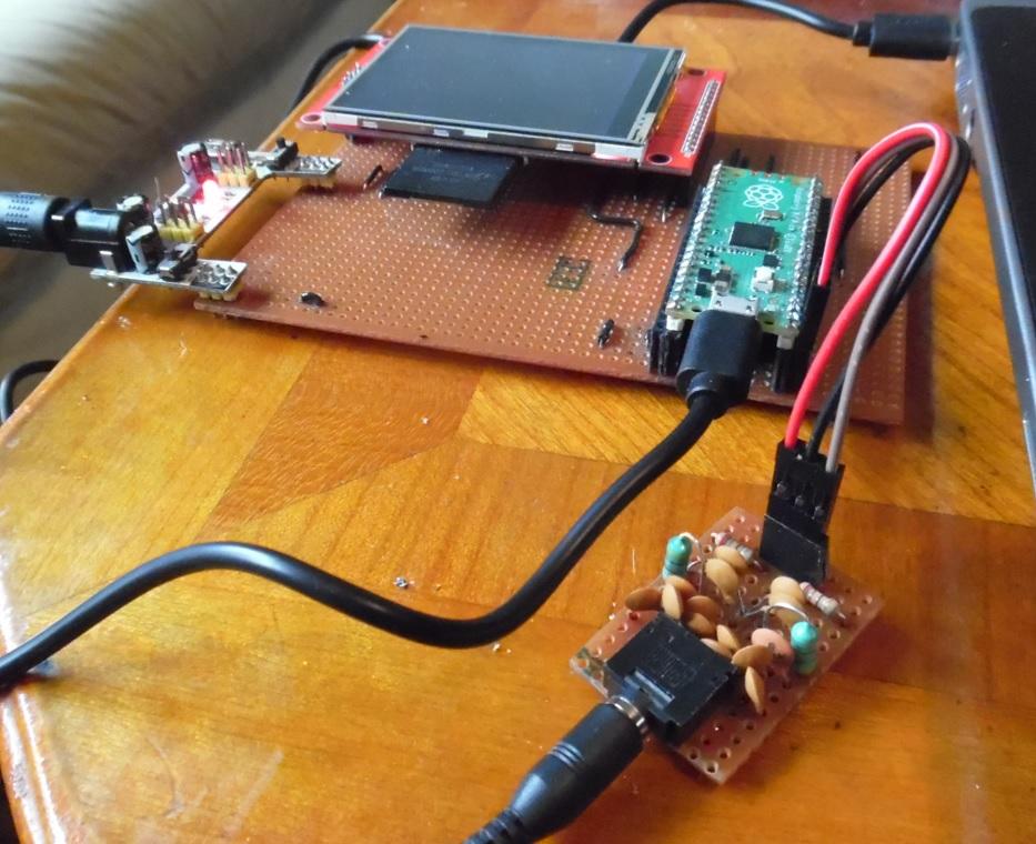

4.7mH inductors arrived today so built the low pass filter and tried play tone 1000,500,2000
it worked!
Check the photos of the ebay £14 stereo, runs off battery/usb, rechargable. Womans voice says blue tooth mode when turned on then pressing mode says fm mode, pressing again says a u x mode which I'm using, next says u s b mode. Great for the price.
I didn't have the caps for the filter so
68nF was 47nF + 22nF in parallel.
33nF was 22nF + 10nF in parallel,
2.7nF was 2.2nF+ (1nF + 1nF in series) in parallel,
would have been simpler with the right caps... see the photo
but sounds seem ok, I'm happy my soldering with my vision it worked.
