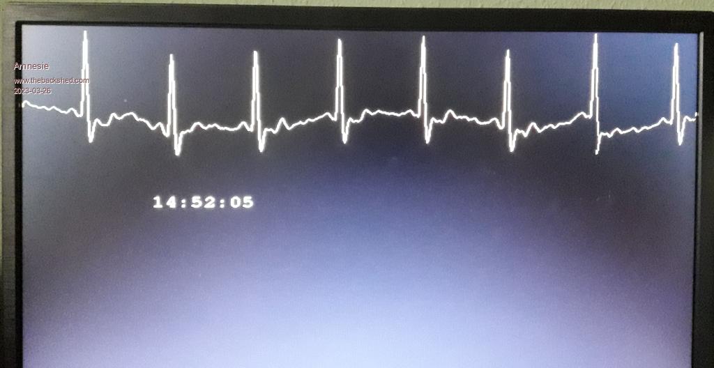

My final application is my ECG, which works good but needs some grid in the background and I thought it would be much better with framebuffer than drawing horzontal and vertical lines.
This is my ECG, which works good so far, but a background grid would be much nicer.
SetTick 10, ekg_interrupt 'Abtastrate 100Hz
SetPin GP28, AIN
SetPin GP25, DOUT
Font 2,1
CLS c
RTC gettime
 'Tiefpass
  a0t =  0.1565712872
  a1t =  0.2651425745
  a2t =  0.1565712872
  b1t = -0.5695259524
  b2t =  0.1958111014
 'Notch
  a0n =  0.7857841106
  a1n = -8.4007020142E-16
  a2n =  0.7857841106
  b1n = -8.4007020142E-16
  b2n =  1.1915682213
 If x>MM.HRes Then
   x=-1
   'Save image "bild.bmp"
ekg_interrupt:
 'Show Time
 Text 120,210,Time$
 'Increment
 x=x+1
 ekg = Pin(GP28)
 'Filter 1
 sn_2 = s_n1
 s_n1 = s_n
 s_n  = ekg
 g_n2 = g_n1
 g_n1 = g_n
 g_n  = s_n*a0t+s_n1*a1t+s_n2*a2t+g_n1*b1t+g_n2*b2t
 ekg  = g_n
 'Filter 2
 sn_2 = s_n1
 s_n1 = s_n
 s_n  = ekg
 g_n2 = g_n1
 g_n1 = g_n
 g_n  = s_n*a0n+s_n1*a1n+s_n2*a2n+g_n1*b1n+g_n2*b2n
 ekg  = g_n
 'Drawing
 Line x,0,x+1,MM.HRes,1,BF
 Line x-1,ekg_alt*140,x,ekg*140,1
 ekg_alt = ekg
IReturn

Thank you a lot, this helped me to understand how it works!
