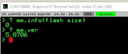

@Peter
A stupid question: what does mm.info(flash size)?
When I type print mm.info(flash size) it returns 0
I know it would report the size of flash memory, but what memory?
I use the 5.07..07b28 version.
Did I discover a new bug or is the flash memory an optional thing?
The flash slots do work and the A: drive also.

Posted: 08:36am 23 Mar 2023
Yeah, I am getting that also.
mm.info(flash) returns the flash slot currently running a program - normally 0
mm.info(option flash size) returns the size of the flash memory chip
Posted: 08:41am 23 Mar 2023
Manual page 74 says to use the former.
When did the syntax change?
...or the manual needs updating.
EDIT: Option Flash Size crashes the PM, but it could be cos I am using a version below, so I will update and try again.

Posted: 09:28am 23 Mar 2023
  matherp said  mm.info(flash) returns the flash slot currently running a program - normally 0
Thanks... so it becomes the time that the manual has to be updated, because a lot has changed.

  Grogster said  Manual page 74 says to use the former.
To inform you, mine is not crashing, latest beta as mentioned in my first message.
