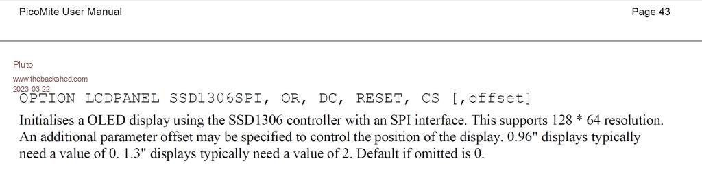

Yes you have to connect all. See the p.44 in PicoMite User Manual MMBasic Ver 5.07.06 (if you are using PicoMite).

If it's been converted from SPI to I2C then I can't see why the SPI information is relevant.
