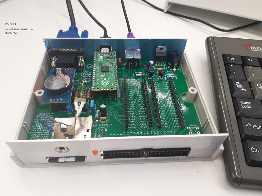

Peter's vision...
This will fit 2 HAT's....

Ok, you want a pi zero hat connector to a picomite.
Sorry, misunderstood.
There is one thing to take into account: On the VGA mite there are not many IO pins unused (10 in total, 7 digital, 3 analog/digital), and you could add to this the I2C bus (2 pins). We have to carefully plan the pins on the 40 pin (hat) header to make best use of the available hat's.
