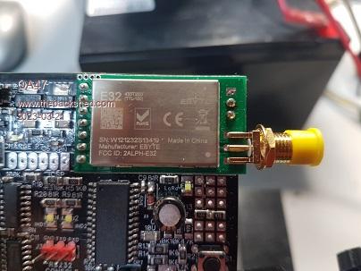

I have been using the Ebyte E32 433Mhz LoRa module for a number of years to enable the Micromites to communicate with each other. Like these ones:

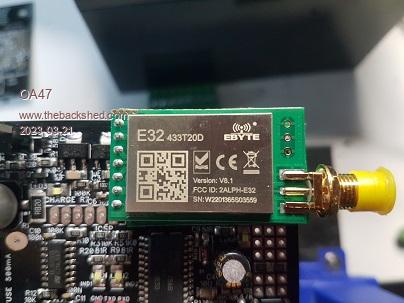

As I wanted to extend the current network of units, I ordered another quantity of units like these:
I then spent a large amount of time chasing transmission faults and banging my head against the 'shed ' wall. In the end I contacted the manufacturer and here is parts of their reply:
  Quote  Now the models are V8 version . If your old orders are bought long time ago. They can not communicate .
  Quote  Sorry We don't sell the old versions
I have put up this post in the hope another shedder does not get caught with this scenario.

I went back and re-read the online ad for these units and it does say that they are Version 8 but does not indicate that they are incompatible to the Versions 1 thru 6. It is bad enough trying to avoid the clones these days for this type of situation but another to find out after the purchase from the manufacturer.

Found this on passion-radio.com website
  Quote  Version 8.1, it works with all older versions only when the data rate is higher than 9.6kbps.
i would presume this is the communication data rate.
