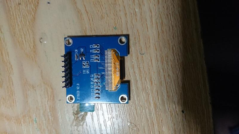

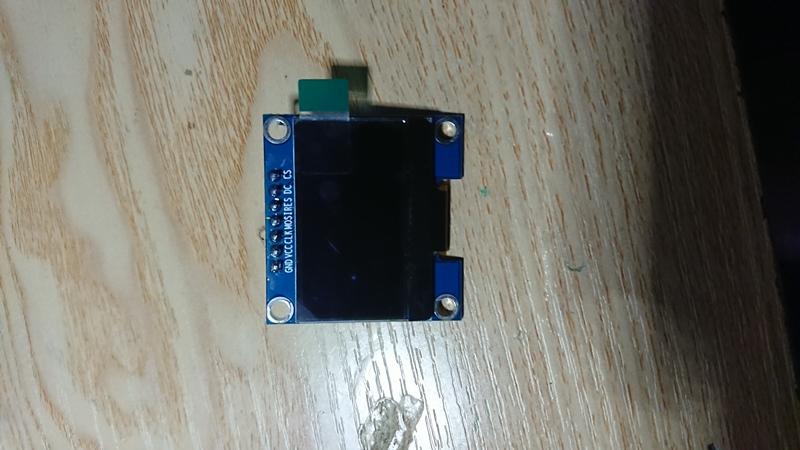

Hi I am only using one display the one display at a time.
I am actually wanting to replace the ILI9341 with the SSD1306
I purchased two of these SSD1306's and they both arrived configured as SPI
I converted one of them to I2C and that works perfectly.
However I want to use the I2C for a RTC and hence would rather use SPi for the Display as I have already done using the ILI9341.
Pics below

I would rather keep the SSD1306 on SPI as I already have pcb boards made etc.
I am using these on a Raspberry pi pico under mmbasic
This is the pinout is have used between the pico and the display.
GND >> GND
VCC >> VCC (tried 5v and 3.3v)
SCLK >> GP18
SDI(MOSI)>>GP19
SDO(MISO) >> GP16 (not used) (Just configured for option system spi)
RESET >> GP14
DC >> GP15
CS >> GP13
