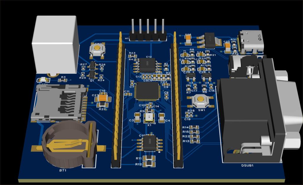

And this is the PCB. All of this was created in a single day completely manually (no import of the DesignSpark files possible).
Overall, I'm impressed and can highly recommend EasyEDA for anyone who wants to get into PCB design.

That looks like a very good system! The schematic alone is a huge improvement.

The schematic looks very clear - but I was surprised that not everything is as searchable as I expected, e.g. both GP29s are found but both GP19s (& others) are not.  Might be something I'm doing wrong?
The 3-D board view is great!

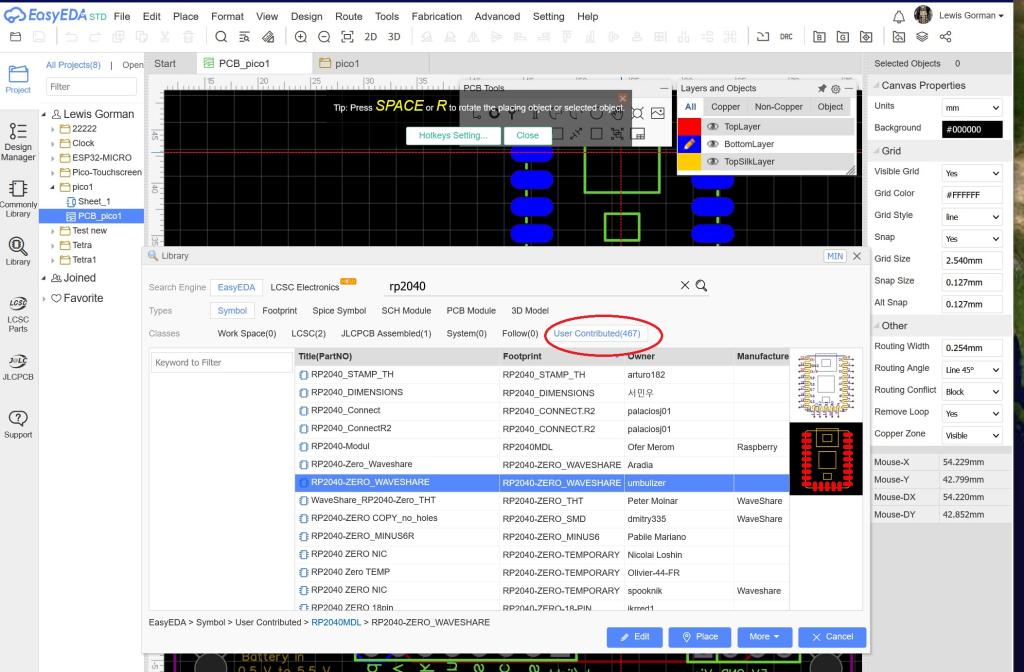

I just did my first EasyEDA PCB about a week ago. First time I've used AutoRoute and it was fine (a pretty simple design). With EagleCAD, I've run into the same problem with a lack of parts--and I've only succeeded with making my own with the most simple layouts.
I was happy that EasyEDA had the part I was looking for: a PJ-325M mini Stereo Female Socket which was both panel mount (with threaded post & nut) & PCB mount.

I've been using it for a few years now
You can make your own components if they aren't included
but I find the under search for a component "User Contributed" section it almost usually has anything required

Posted: 03:25pm 18 Mar 2023
My only complaint is that with nearly everything being user-generated... you are kind of in the wild west of results... seeing that many people have different ideas about line widths, filling the IC symbols with yellow (ala PROTEL) or not... etc. So your Schematic can look like a Ransom note if you are not careful to fix the parts you find.
