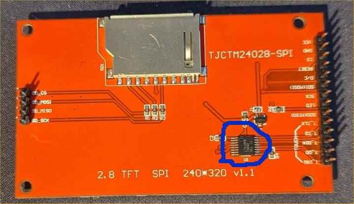

Posted: 06:18pm 19 Mar 2023
Easiest by far is this
Otherwise a ILI9341 off ebay but if you want touch make sure it has the chip fitted
