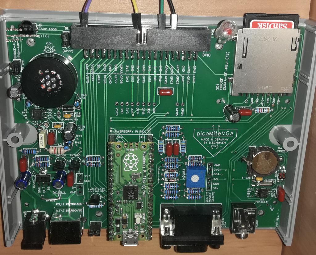

The latest PicoGAME VGA mini 6 has the SD card supply filter, as do the PicoGAME 1.4 and the PicoGAME  2.0.

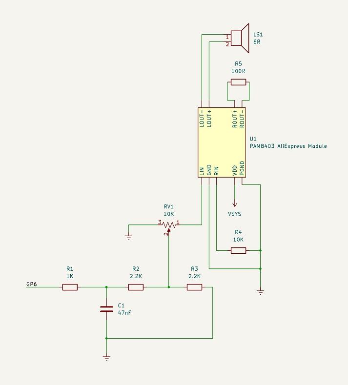

Hi folks,
I'm still struggling with this, both with ticking and hissing when using PLAY SOUND:
   https://www.youtube.com/watch?v=4fvh2d3T42U
1. It's not the SD card, it sounds the same with and without the LCD/SD module attached.
2. There is more hissing when running from the battery than from the Pico/USB.
3. I can "hear" the heartbeat LED flashing as a hiss.
4. The output from PLAY WAV is acceptable, no ticking and not significant hissing.
I'm looking to remove/reduce the tick and the hiss, I realise the former may be something that if completely fixable will require me to improve the software, but I'm guessing the latter is a matter of scattering capacitors/resistors/ferrite beads like confetti .
And no I haven't done, or understood everything that has been suggested, I'm even more out of my depth with analog than I am with digital electronics.
Here is my current schematic:
The low-pass filter is the original PicoMite one, I've also tried the one in the more recent PicoMite manuals (4.7mH/2.7nF/33nF/68nF) on solderless breadboard and it didn't seem any better .
What I'm planning to try next:
1. Try a soldered version of the improved filter.
2. Put both a 100uF electrolytic and a 0.1uF between power and ground on the main PicoGAME LCD after the battery switch - which I think is what @Turbo46 is saying ?
3. Update my music engine to remove redundant calls to PLAY SOUND when two consecutive "notes" are the same.
Any other specific suggestions are welcome,
