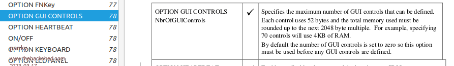

option gui controls 4 in teraterm seems to have sorted gui controls but says maximum is 3 not 4, so set option gui controls 10.

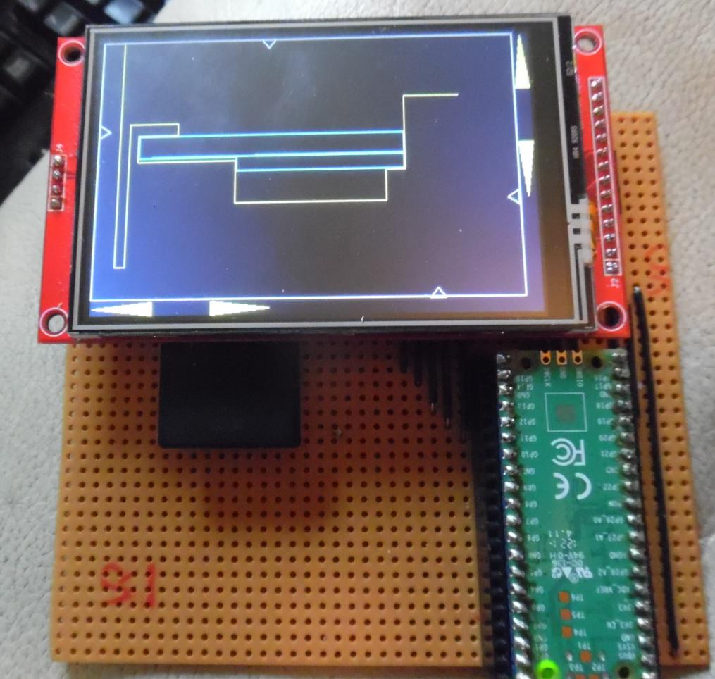

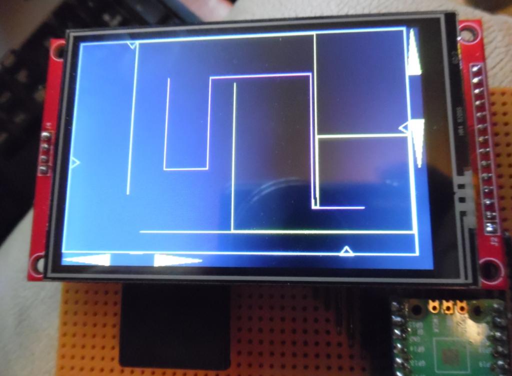

Posted: 05:36pm 17 Mar 2023
Thanks all for helping me. I did read the manual but didn't get gui controls relevance
my simple tron

As the amount of RAM used for GUI CONTROLS is rounded up to 2048 bytes anyway there's no point in specifying such low numbers. One control will require 2048 bytes as will 39 controls (39*52=2028 bytes). 40 controls will require 4096 bytes of RAM.

It's in the manual but option gui controls isn't really mentioned and the number of gui controls could be better explained imho. pixel page 111 and 135,why not same page?
