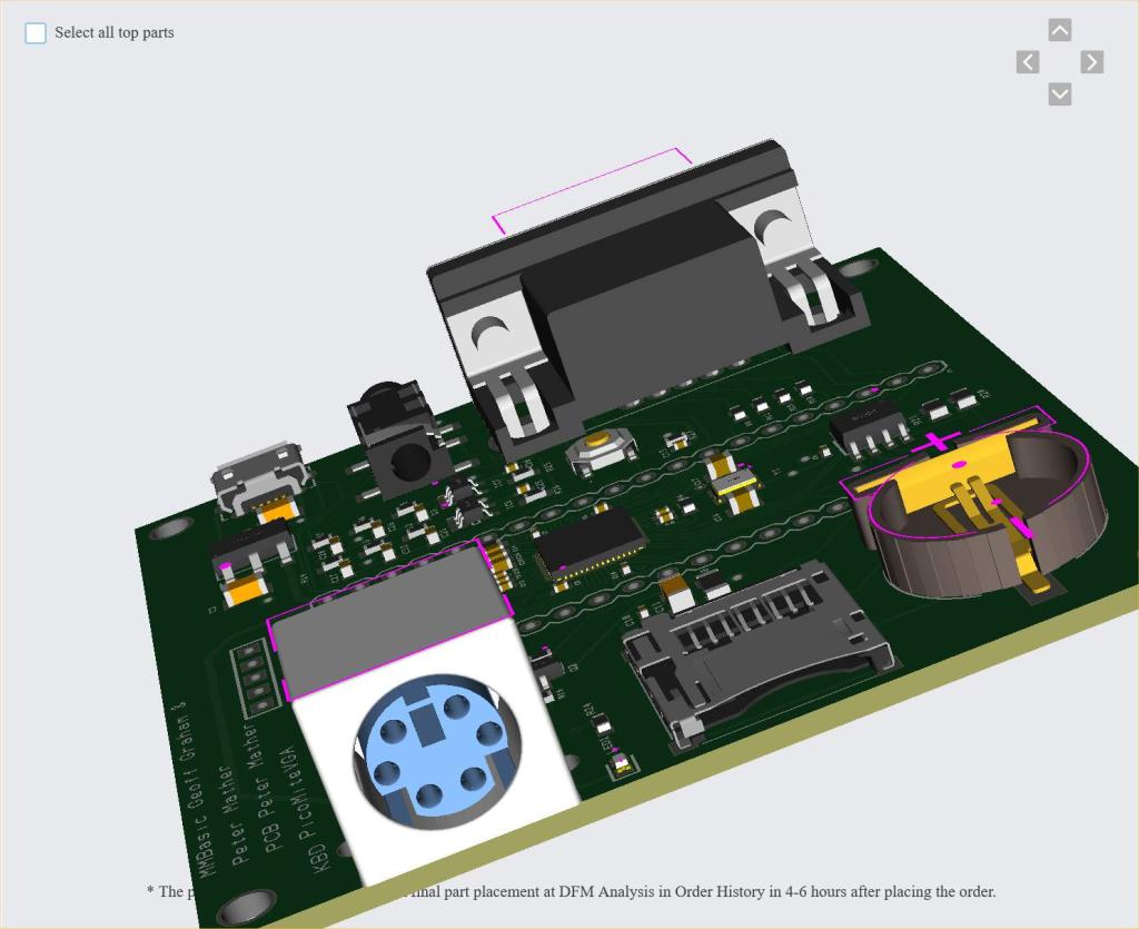

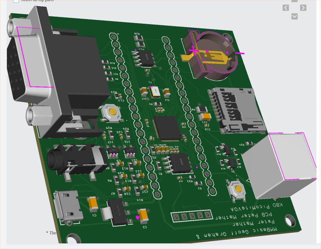

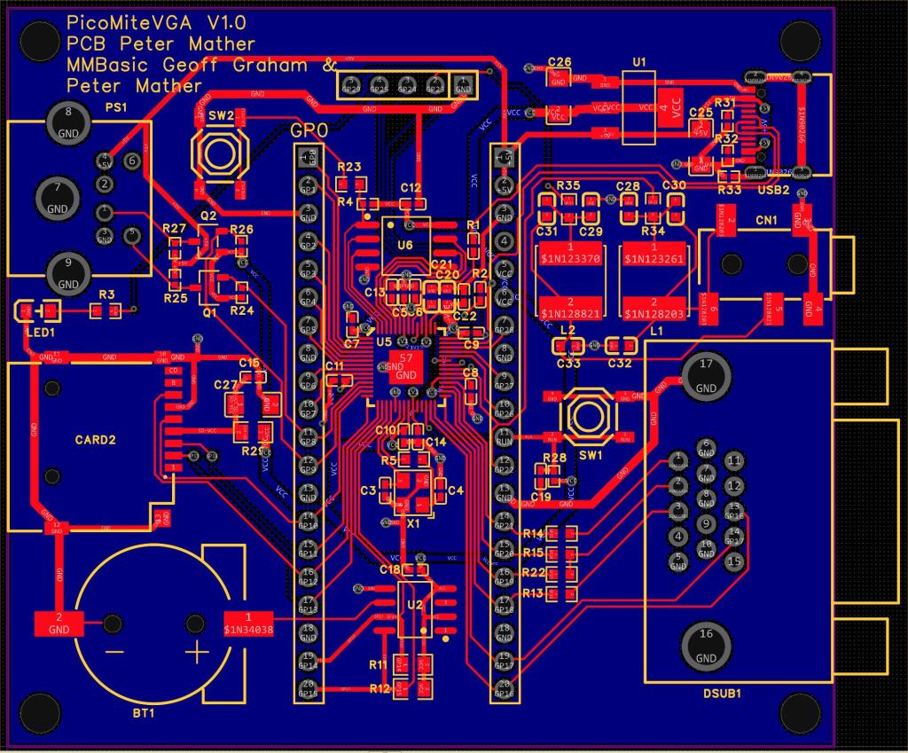

I have designed a ground up PicoMiteVGA including 16Mbyte Flash, DS1321 RTC, Volhout's high spec audio filter, micro-SD, PS2 etc.
This doesn't use the Pico but is built from the RP2040. Every component used is available in quantity from JLC and the price above includes them soldering everything.
i.e. for a complete ready-to-run board
I have included a Pico footprint so you could add any of the Pico format modules (e.g. GPS)
Unlike the Pico all pins are broken out.
The majority of the price is in the "non-standard" components - the RTC itself is GBP3 and then things like the SDcard slot, PS2 connector, VGA connector all add to the price but, of course, this is true for a board you build yourself.
If this seems interesting I will get a couple of board made to find and fix any errors.
I love the JLC visualisation software - you can even see the through hole pins sticking through the board
The board is 75x67mm double sided so cheap as chips but uses small components so I wouldn't recommend hand soldering

Very nice looking Peter, likely worth a few boards to gauge interest. I think you intended NOT hand soldered (at least for me) but would be interesting to see prices as bare board, BB and all SMD in place and total assembled.

That's very nice indeed. Is it a micro USB (which it looks like) for power or USB-C?
Posts: 3417
Posted: 10:05pm 15 Mar 2023
Not enough pins for USB-C
Posts: 9249
Posted: 10:21pm 15 Mar 2023
True, which is a pity.

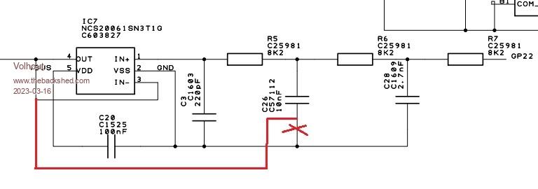

Peter,
C22 and C26 should connect to the opamp outputs, not to ground.

Peter,
Your design looks good.  The only downside that I can see is that once you put it into a case, the press buttons aren't accessible.  I'm guessing that it adds to the cost to make the right-angle on the edge of the PCB.
A good trick that many cheap TV boxes do is to put a right-angle boot switch at the end of the stereo socket so that it can be pushed by a toothpick as the unit is turned on.  It's usually only required when re-flashing the firmware.  Something to consider.
From a purchasing perspective, would they need to be purchased via you in the UK, or could they be purchased directly from JLC PCB?

@Peter,
This needs fixing (both channels L and R)
Edited 2023-03-16 19:31 by Volhout
Posts: 12074
Posted: 09:33am 16 Mar 2023
Done thanks

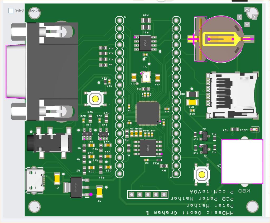

Minimum is 5xPCB with 2 built. PCB cost is so low as to be irrelevant GBP1.65 for 5
Note that if ordering yourself you can leave off any components you don't want and save cost. e.g. leave off the RTC and save GBP3 per board.
This could include leaving off the VGA components if you just want a normal PicoMite with the SDcard/audio etc. all wired and guaranteed working.
Just delete the unwanted components from the BOM and CPL (both excel files)
As can be seen in the pics the PCB is organised in modular areas: VGA, audio, SD, PS2, RTC so it is easy to know what can be omitted for each function

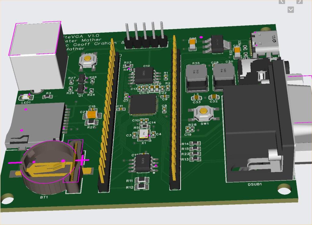

See the EasyEDA thread for a USB-C version
Posts: 12074
Posted: 02:23pm 01 Apr 2023

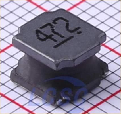

I've finalised the design having eventually found a nice SMT 4.7mH inductor.
So I've sent the files off to JLC to build. Will report on receipt.
Final spec is:
RP2040
16Mbyte flash
DS3231 RTC
micro-SD slot
PS2 I/F
VGA output
All pins broken out so 13 pins unused: 4 analog (GP26-GP29), and GP0 to GP7 + GP24
linear regulator
USB-C
Boot and reset switches
All parts in stock at JLC so it can be built by them as a complete fully working unit
My experience is that Volhout's inductor based filter is by far the best at removing the 44.1Khz and leaving a really nice clean output.
