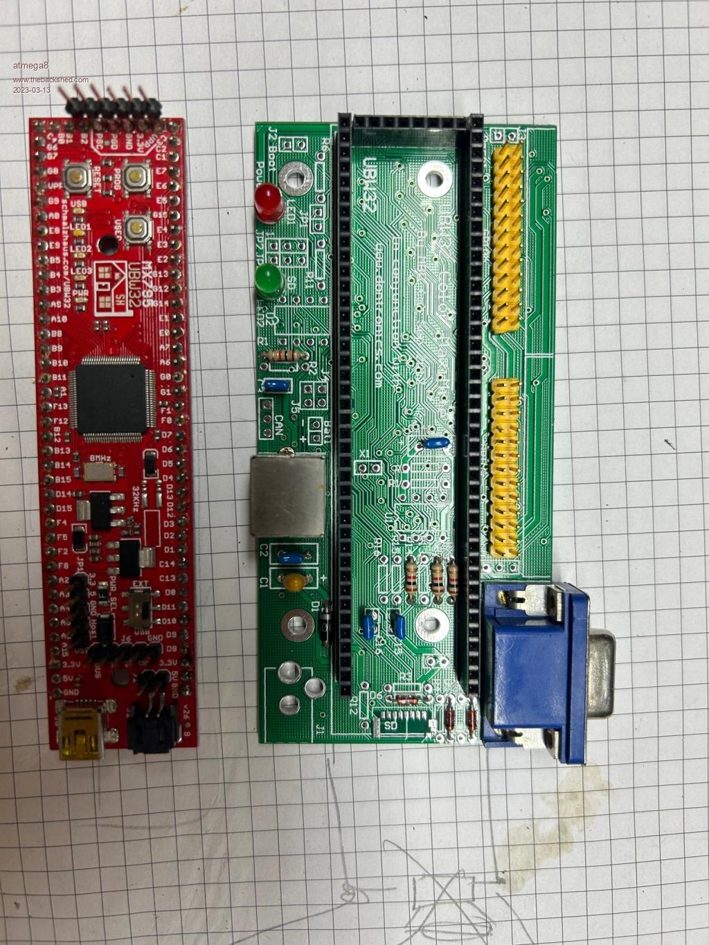

I also found this baseboard from ( Dontronics?) and now it’s Time to bring this Combo back to life.

Posted: 07:25am 13 Mar 2023
Thanks for uploading that manual Jim,
I wrote it many moons ago and was looking for it when I saw you had beaten me to it.
If there is still any interest I will upload the gerber files to get the PCB board built from JLCPCB
Mick (MBG)
