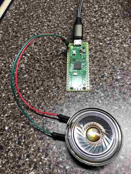

After playing with Colour Maximite MMBasic a year or so ago, I finally got around to buying a couple of RPi Picos and installing the most recent excellent version of MMBasic.
Blinking LEDs is pretty old at this point, so I tried demonstrating sounds.
The manual (and others) indicate that a low-pass filter is needed, and rather than scrounge for coils and caps in my junk box, I just connected a small (4 cm) crappy speaker to pins GP0 and GP1 using jumper cables. It worked!
I have a music background, so I wanted to test the (alleged) floating-point specification of frequencies in the PLAY TONE command to see if I could get "equal-tempered" tuning - that worked too!
Here's the program. Enjoy!

DO NOT DO THIS...
... unless you are using a high impedance speaker or you insert a 220R resistor in series with an 8R speaker.
There is a danger of overloading the IO pins and even exceeding the maximum IO current for the RP2040, causing damage to your PicoMite as an 8R load is *way* out of spec.
The volume will be lower with the resistor, but it will bring peace of mind. :)

The low impedance speaker and inductive load can destroy your pico output. As Mixtel90 already said: not without protective resistor. Or better a high impedance speaker or use an amplifier.

Thanks, everyone, for your sage advice and cautions. Fortunately, the speaker I'm using is a 200+ ohm membrane speaker that is working quite happily connected directly.  My main intent was to ascertain the necessity for a low-pass filter, and I'm satisfied that, for the PLAY TONE statement at least, it's not necessary.
In a continuation of my experimenting, I put together a variation on the above theme, using the two-sound combination of the PLAY TONE statement to achieve a functional DTMF dialer. At least in the U.S., just holding the mouthpiece of a desk phone over the speaker is enough to dial the phone!  Listing below (that's the phone number for Directory Assistance in our area code, if such a thing still exists). My coding style yearns for the equivalent of C structs, but then this wouldn't be a dialect of BASIC.
On a related note, I have been watching the excellent Cornell University course on the Raspberry Pi Pico 2040, and have a somewhat better understanding of how Geoff and Peter are working their miracles. However, sufficiently advanced technology is still indistinguishable from magic.

Even at 200R you are exceeding the maximum load. You are driving the speaker in push-pull so there could up to 6.6V across it. That gives an output current of 33mA. The outputs from the RP2040 sag under load, but their maximum usable current is 12mA from any one pin. That's the current you should be trying not to exceed and would imply a minimum load of 550R. Even if you use a single output to ground that speaker will draw 16.5mA.
The Pico has poor output current capability. The Arduino range are far better in this respect.
You are probably getting away with this only because the two outputs are the only ones in use so the chip may be able to handle the excess dissipation. It's not a "good thing " to push the manufacturer's spec too far or the magic smoke can escape. It's possible that the sagging output voltage is also what is (for the moment anyway) protecting the outputs against back-emf spikes from the inductive coil of the speker.
Because of the voltage drop on the outputs as the load increases you are probably not getting much (if any) more output from two outputs than you would from one to GND. A single output and a very simple one-transistor amplifier would be the way to go. That would allow you to use a higher voltage across the speaker and get more output.
I like this "quick and dirty" approach to speaker driving, but it has problems. :(
