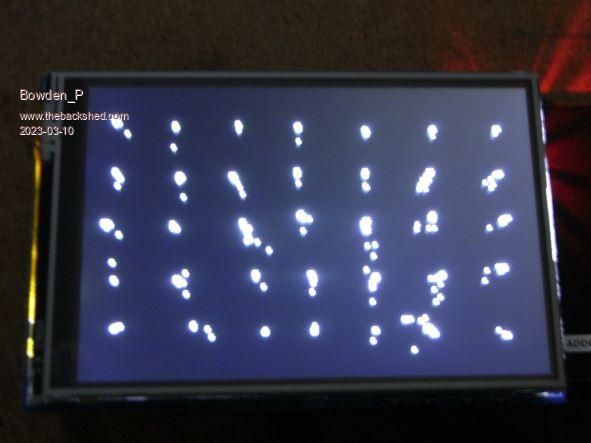

Both exhibit screen splatter when the "GUI TEST TOUCH" test is run.
This is a typical result when making a 7 x 5 array of touched points :-
Most - but not all - of the rogue pixels appear on the touch release.
Repeating "GUI CALIBRATE" doesn't appear to change this.

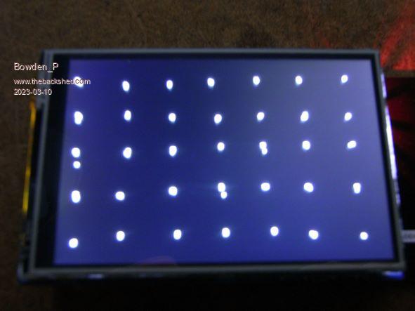

If I run this code :-
' Touch screen test.
' Provides 3 x 3 pixel plots under the touch point.
 OPTION EXPLICIT
 OPTION DEFAULT NONE
 dim x%,y%,i%,j%
'SETPIN GP17, INTL, Touch_Int         ' Use this if "OPTION GUI Controls" is zero.
 gui interrupt Touch_Int
 cls
 DO : LOOP
SUB Touch_Int
 x%=TOUCH(X):y%=TOUCH(Y)
 for i%=-1 to 1
   for j%=-1 to 1
     pixel x%+i%,y%+j%
   next j%
 next i%
END SUB
I get this result :-
Just wondering if my screens are at fault. Has anyone else seen this ?

Posted: 05:33pm 09 Mar 2023
Not sure what the issue is. Your test looks pretty much perfect. GUI TEST TOUCH doesn't purport to be anything more than a very simple test that touch is working and the line tracks the stylus when it is kept in contact and moved. It does not do anything to remove release artefacts

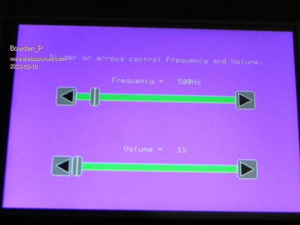

When I have used GUI TEST TOUCH before it has given a reasonably clean response to single touches, and also good at line drawing. For this screen single touches come out as a bit of a mess! ( Hence my screen query.)
I am experimenting with controlling frequency and output level of an oscillator using 2 slider-like graphics, but the jitter I get is causing very erratic behaviour, akin to the GUI TEST TOUCH response. ( I also hope to use some Advanced Graphics features.)
I have based these graphics on one used in a previous project using a Micromite v2 to control a servo, which worked very successfully, so hoped to do the same here.
With best regards, Paul.

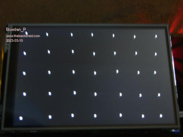

Posted: 08:35pm 09 Mar 2023
Hi Peter,
Wow - that's quite an improvement, as below!!
Thank you very much! There are 5 points showing a second point plotted, but they are nevertheless very close to the original.
I have also tried my slider graphics, which now work very much better too!
May I ask what the fix was?
