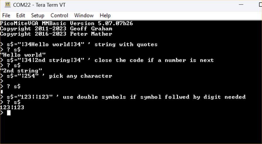

Building strings that need non-printing characters or double quotes requires use of the chr$ function and string addition and is somewhat clunky.
C uses the backslash character to do this
e.g.
char string[]="\"quoted string\"";
and there are variants of this like
\nnn where nnn is the number to be inserted e.g. \034 for a quote
In MMbasic we can't use the backslash as it is used in filesystem pathnames but the
| character (ascii 124) is unused in MMbasic syntax and very unlikely to be used in text strings
I've been playing with this
It can also be used in data statements
Thoughts - do I keep this in for the next beta?

Posted: 06:57pm 08 Mar 2023
  Quote  how would you distinguish between:
a$=chr$(2)+"345"
and
a$=chr$(23)+"45"
Already covered in the first image

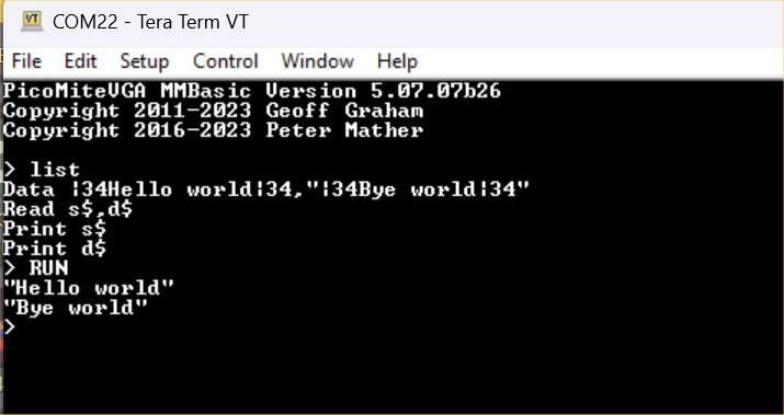

chr$ can't be used in DATA statements. Also, concatenating strings will be much slower (factor of 3 in simple test)
  Quote  > timer=0:for i=1 to 1000: s$="|34Hello World|34":next:print timer
13.684
> timer=0:for i=1 to 1000: s$=chr$(34)+"Hello World"+chr$(34):next:print timer
40.375
Edited 2023-03-09 05:01 by matherp
