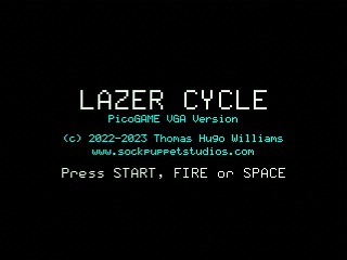

Downloaded the PMVGA version, try to run on Peters VGA board using keyboard (no controllers (or pullup resistors), just floating GP pins) and the game is stuck on the startup screen (pressing "SPACE" won't start it).
Any part of the code I can adapt to make it run.
PicoMite 5.07.07RC4
Edited 2023-04-17 19:59 by Volhout
Posted: 10:10am 17 Apr 2023
Hmm, I wonder if the floating pins give the controller detection code apoplexy, that would be a bl**dy nuisance, the only VGA boards I have to test with are PicoGAMEs.
EDIT: Though if that were the case I'd just expect it to start with some random controller rather than not start at all. I don't suppose a non-UK keyboard returns a different PS/2 scan-code for space ... seems unlikely.
