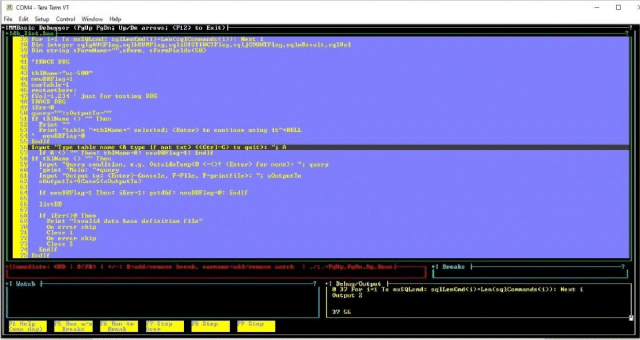

Posts: 3871
Posted: 03:06pm 07 Mar 2023
  Mark said  I am writing some "utility" type programs
Here's an example of MMBasic using serial output to a terminal (TeraTerm) and doing old-style text windowing with VT100 commands:
I didn't use the console because I wanted to leave it free for debugging.

lizby:  That screen demonstrates exactly what I want to do with my program.  I'm currently using the USB console, but I like the idea of using a serial terminal
