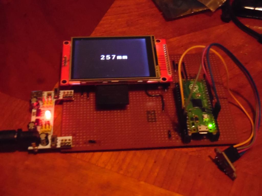

Posted: 07:02pm 05 Mar 2023
Dim d$
SetPin gp4,gp5,i2c
I2C open 100,1000
Const i2caddr=&H29
I2C write i2caddr,0,2,&H89,&H1
Font 5
Pause 200
CLS
getdistance
Pause 100
Sub getdistance
I2C write i2caddr,0,2,0,1
I2C write i2caddr,1,1,&H1E
I2C read i2caddr,0,2,d$
Text MM.HRes/2,MM.VRes/2, Str$(Str2bin(uint16,d$,BIG),3,0)+"mm",cm
'Print Str2bin(uint16,d$,BIG)

Your code works on ili9341 lcd. Thanks. Seems you have the vl53lox. I like it more than ultrasonic range finders for robot avoid obstacles. Your code as an example in the manual for others maybe.
I added a space for the display or it left chars on the display
Text MM.HRes/2,MM.VRes/2, " "+Str$(Str2bin(uint16,d$,BIG),3,0)+"mm",cm
