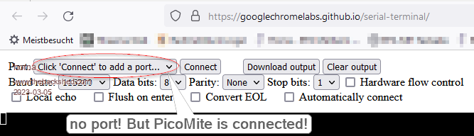

This ?
With a PicoMite VGA with USB serial console ?

Mint 21, latest Firefox - initial screen comes up, tick boxes active but no response to serial device (ACM0 115200)
No indication of how to set specific/dev/tty device.
Had a look at the source html and can not see any linkage to USB pseudo port - maybe it needs to be opened under chrome which may understand the ' terminal' command near the bottom?

https://googlechromelabs.github.io/serial-terminal/
Yes ..... " googlechromelabs " maybe Chromium only ?

Tried it with Opera browser on W10 and it seems ok.
When you click on 'Connect' it shows serial device list (inc serial over USB)
Select one, click connect and the Pico is there.

win11 - Firefox 110.0.1 (64-Bit)
What is the idea behind this method?

  hitsware2 said  This ?
Works fine for me - except the backspace character is wrong.
