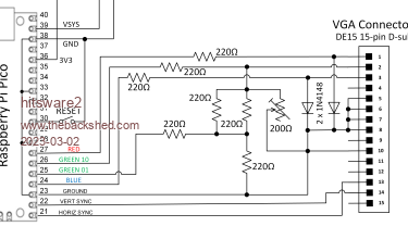

Easy to do but you gain nothing as the firmware always reserves two pins for the synch signals and four pins for the video data. If you load the four video pins with series resistors in a binary series (1-2-4-8) then use an emitter follower to drive a single video output you can get 16 grey shades (including black and white).
Posts: 3418
Posted: 09:32pm 01 Mar 2023
A single 270R from any one of the 4 VGA colour pins on the Pico to any one of the three colour pins on the VGA socket (1,2,3).
In Mode 1 where a foreground colour needs to be specified use 1
In Mode 2 use RGB(White) or 2^24-1 (eg Const W = 2^24-1)
If using the Pico Blue pin that can be reduced to 255.

No diodes. The diodes were included in that circuit to clip the the drive to about 0.6V. Only very old, cheap CRT monitors with no beam current limiting require that to prevent "Burning" the screen phosphor. Even the cheapest LCD can clip the level at 100% brightness.
Edit
The minimal 16 colour version is just 4 resistors.
R -> 270 -> 1
GH -> 390 -> 2
GL -> 820 -> 2
B -> 270 -> 3
Edited 2023-03-02 08:27 by phil99

Like this ?
          Green Only
 Pico                   VGA
  28 x--------220-------x 2
  23 x------------------x 5,6,7,8,10
  21 x------------------x 13
  22 x------------------x 14
my site
Posts: 3418
Posted: 07:37am 02 Mar 2023
Almost, Pin 28 is a Ground pin. 220R should work but 270R puts a little less load on the Pico pin yet still gets close to 100% brightness.
Although Pin 24 (GP18) is the Blue signal it has the lowest colour number so any number from 0 to 127 is Black and 128 to 255 is Green with the following connections.
         Green Only
Pico pin                     VGA
 24  GP18 blue x---------270--------x 2 green
 23  Gnd x--------------------------x 5,6,7,8,10 Gnd
 22  GP17 V Sync x------------------x 14 V Sync
 21  GP16 H sync x------------------x 13 H sync
hitsware2

For mono the names of the Pico output colours don't mean anything, only the VGA pin it is connected to affects the colour. Hitsware2 will be connecting it to green (pin 2).
Any of the 4 outputs can be used, it's just a little simpler to use the Blue output as noted in my previous post.
If OPTION COLOURCODE ON is used it will colour the editor in TeraTerm but make the monitor unusable for editing.
Going colour requires just 3 more resistors. Then when you want mono just use RGB(green) for every colour.
Latest VGA manual, top of p6 shows how to connect it.
