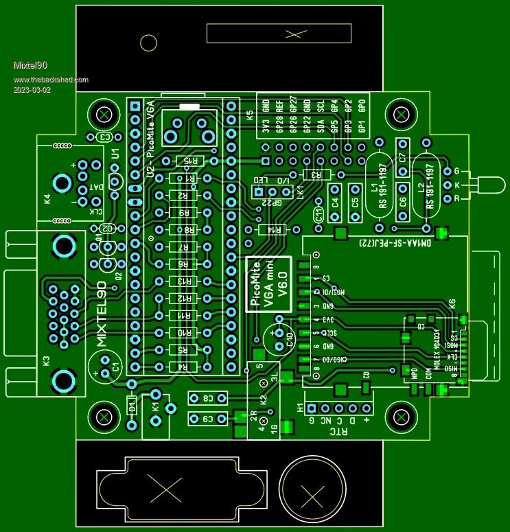

I've kept going back to this for a while and this is the latest incarnation, Version 6.
It still fits the same 90x70x28mm case from ebay etc. but now it has:
Linear regulator by default.
Volhout's auio filter.
Choice of standard or micro SD card.
A 2-colour LED (see below).
> There are now no ebay modules used, it's all standard components.
> The I/O connector has been reduced to 16 pins (8+8) as that uses up all available spare I/O on the PicoMite. This is a common size for ribbon cable.
> The LED is two colour. GP22 can be switched to be used as an I/O pin or to control the green element of the LED. The red element is connected to 5V via a resistor by default (Power On indication) but this can be disconnected and a wire used to connect the TP directly to it. In this case it replaces the heartbeat LED on the PicoMite because its Vf is lower.
> The PicMite has been rotated through 90 degrees, so its USB connector could be made accessible through the side of the case. To make this work it would be better to use shorter headers than usual.
> Almost all the resistors are beneath the PicoMite to keep things compact, but they are reasonably well spaced apart.
If the standard SD card option is used then it should be fairly easy to assemble by anyone who can solder.
Posted: 09:49pm 01 Mar 2023
A time-warp board, judging by the silkscreen!
Looks good.

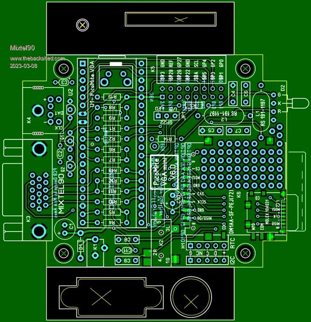

Posted: 03:08pm 07 Mar 2023
Quite a major re-hash, hence the delay. :)  Many of the changes are subtle, but there are some pretty obvious ones.

PilotPirx
Joined: 03/11/2020
Posts: 164
Posted: 03:43pm 07 Mar 2023
Looks a bit confusing now. What are the extra holes for? Experimental field?
Does it make sense to do without an external voltage regulator?
With the SD card, RTC and LED, it can add up to a few mA.
Posts: 9253
Posted: 04:08pm 07 Mar 2023
The "sea of holes" is for you to play with if you decide to use the micro SD card or neither. The external linear regulator is completely optional. It will be used by default but you are free to use the SMPS if you prefer (but there will be noise on the audio). There is enough spare current for the RTC and SD card. The LED is only running at 3-4mA for each colour.
Just a bit of explanation of the changes.
I rotated one of the inductors to get rid of magnetic coupling between them, reducing crosstalk between channels.
I've been asked in the past about including a "sea of holes" in my designs for those who like to experiment. As the SD cards are no longer as important as they used to be I decided to steal some of that board space.
I spread Q1 and Q2 out a bit to make assembly easier.
Having R15 offset from the others annoyed me. That led to some rearrangement of the resistors, together with getting rd of a couple of layout idiocies.
Pads have been added to access the I2C bus from inside the case. They may be useful for something.
JanVolk
Joined: 28/01/2023
Posts: 420
Posted: 11:43pm 07 Mar 2023
Mick,
Good progress and now becoming a universal print with many possibilities.
I've been fitting and measuring with my SD card holder. If I want to mount the SD pcb of (18x18) directly on the PCB then L1 is in the way, but that can be remedied by placing the pin holder between the PCBs or L1 at the bottom of the PCB?
Are the various separate islands fully metalised?
And the lettering at the components could be a bit better like d g s or Inp gnd Out and a k and I haven't figured out yet what the part is under Raspberry Pi Pico at usb?
And I've looked at the schematic, which hasn't been updated yet for this pcb, so it's not easy to check, but I don't think it's the final version yet and well on its way?
