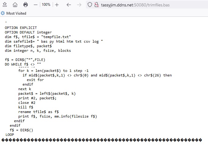

This Basic program strips the offending zero or ^Z characters form any file with an extension in the safefiles list. I am not willing to trim graphics or data (bin etc) files but if you have one that always ends with a standard ASCII character such as <CR>, you can add the extension type to the list.
The program checks the extension and file size. The assumption is that if the filesize is not a multiple of 128 bytes, it has not been transferred by XMODEM.
Only the last 128 bytes are checked to save time and XMODEM will not add any more than 128 characters so that is a valid decision.
It runs on all files on the current directory

I know the problems, since I edit programs in the build in editor to remove the last bugs (main development is in MMEdit) and then transfer back to the PC environment. I normally use a "notepad" alike editor to remove the trailing 0x00's and save the file again with same name.
Thanks for this tool. It may come in handy.
