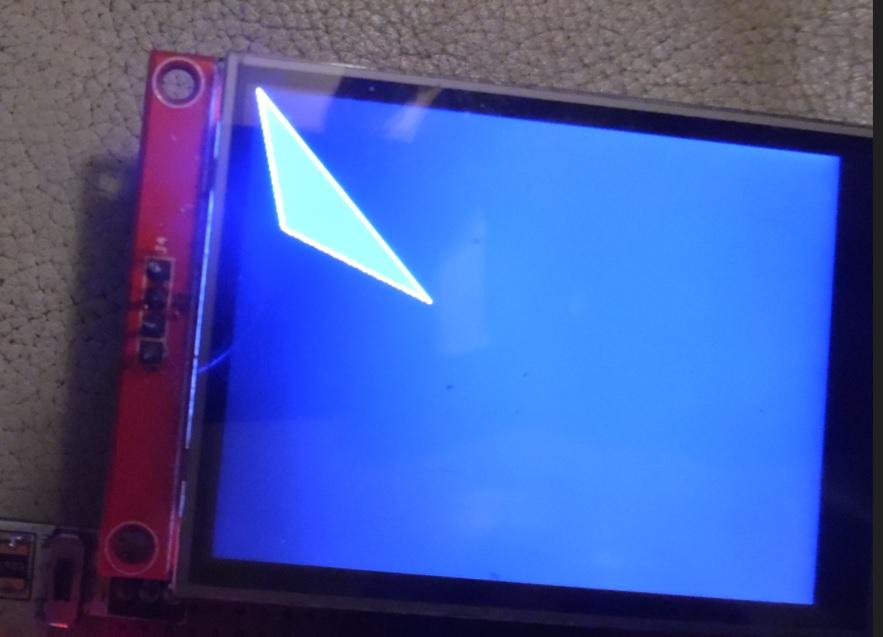

Posted: 04:27pm 22 Feb 2023
This works for me. yellow triangle filled blue. ili9341.

Posted: 05:44pm 22 Feb 2023
Paul, Hi. I'm using PicoMiteV5.07.05b18. This fixed a ssd1306 problem.
which picomite version are you using?
I always use colour abbreviations and this was fine on my ili9341.
I will try real colour values like rgb(255,255,0) for yellow and rgb(0,0,255) for blue
and retest.
regards stan
Posted: 06:08pm 22 Feb 2023
triangle 0,0,100,100,20,70,rgb(255,255,0),rgb(0,0,255) also works fine.
It is yellow triangle filled blue on black background.. camera not good.

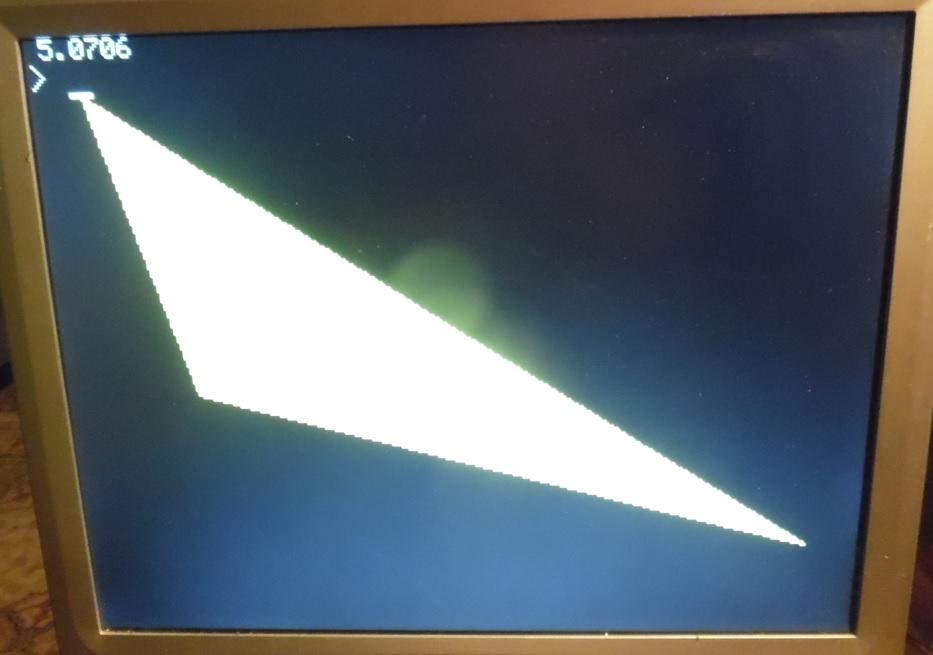

Posted: 08:40pm 22 Feb 2023
Ah, problemo with vga, it fills with triangle shape colour ie yellow in this,not blue.

cls bk
print mm.ver
triangle 20,20,300,200,55,135,ye,bl
triangle 20,20,300,200,55,135,RGB(255,  255,    0),RGB(0,    0,    255)
