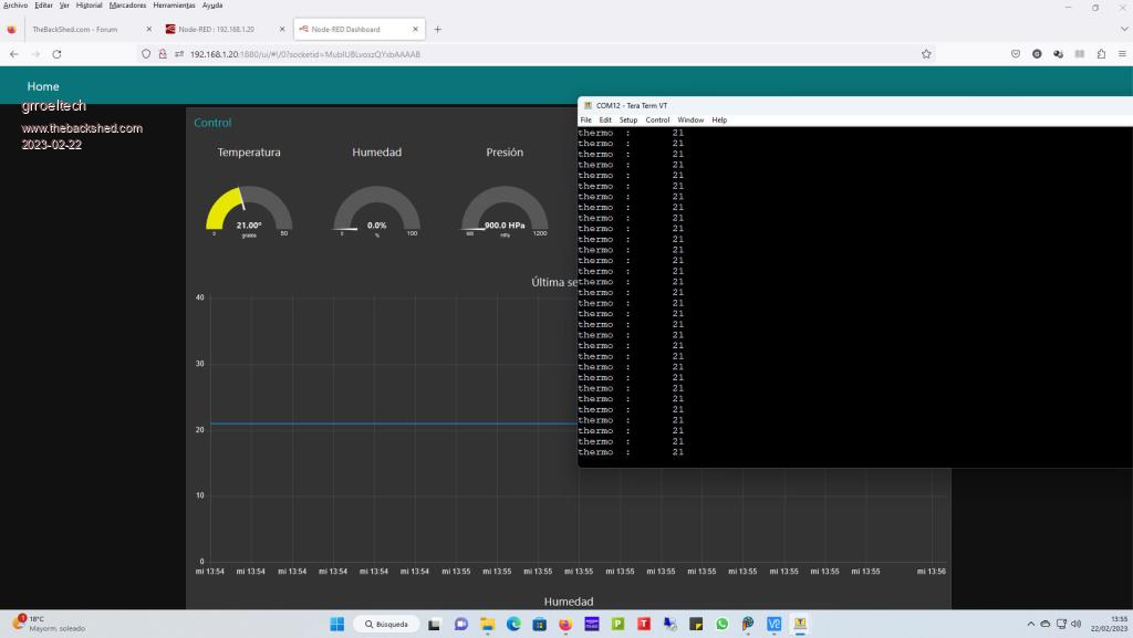

Posted: 01:07pm 22 Feb 2023
Hello,
Good job, the MQTT works fine:
It is a pity that PicoMite does not have support for the BME280 sensor.
Best regards.
