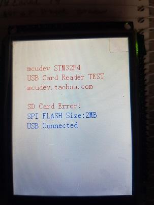

I purchased some STM32F4 black boards and I have found one of the boards will not program via the ST software. I cannot get the unit to register in the cube software like the other units but if I take off the BT0 and BT1 links the screen displays this:
Can anyone offer any ideas?

Are you reconnecting the power with BT0 and BT1 strapped, I have found just resetting via the RST key can be a bit hit and miss, but a full power off/on always works.

Definitely using the usb plug to reset the F4 with BT0 & BT1 Strapped.

Only other thing I can think of is checking continuity from the BT0 pin to pin 94 on the actual chip itself. Also BT1 to pin 37 on the actual chip.

I have traced the BT0 and BT1 pins back to the chip via R23 and R33 so no luck there.

I grabbed another board of the same build (DevEBox V33) and checked the pin configuration and it is recognized by the Cubeprogrammer.
I did reflow the ARM chip and changed the crystal and battery but still the software will not recognize the board. It is strange that there is life when the screen above shows.

It does appear to have a program installed.
If you can't erase it and load your own, perhaps whoever loaded the original program made it write protected in which case I don't know where to go next.
