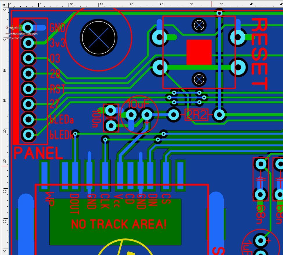

I have settled on 2R2, 10uF and 100n in parallel:
I by no means am suggesting this is the BEST circuit or anything, this just works for me.
Ultimately, try it WITHOUT the RC filter, and if it works for you without issue, you can probably ignore it.  Up until you swap SD cards for one that does cause the problem, that is.
