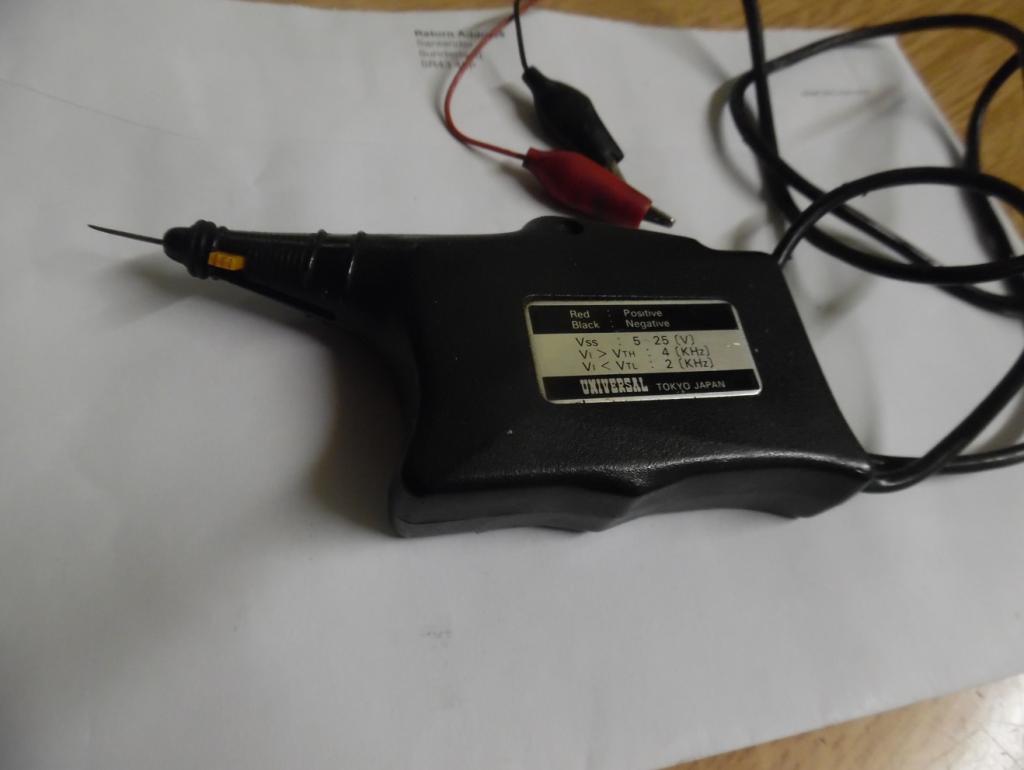

Posted: 07:24pm 17 Feb 2023
Mick - nostalgia from working in a video games factory that made universal games into cabinets. a free tool for analysing logic.
You were supposed to fix faulty ram with these.

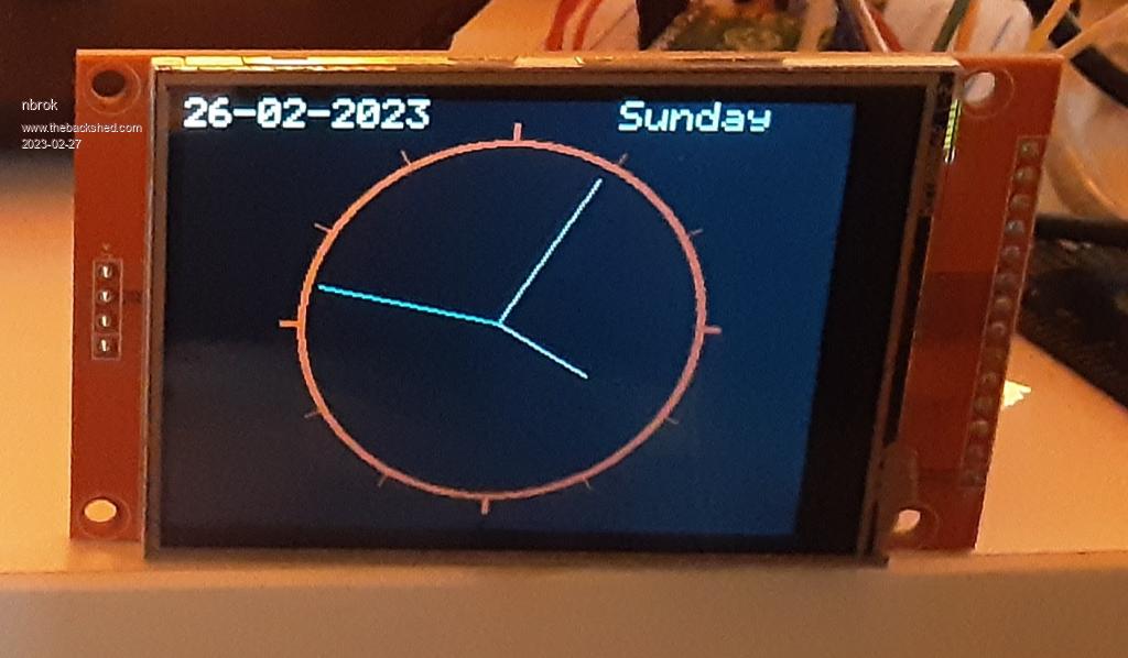

Here the latest version of my clock: In upper left corner the date is displayed and
on the right corner de day of the week:
'A very simple analog clock with digital date and name of weekday
backlight 50                            'Backlight on 50%
cls                                     'Clear tft display
xo=MM.HRes-160:yo=MM.VRes-120:r=100     'Circle is positioned in the middle of
                                       'the sceen with a diameter of 200 pixels
tau=8*Atn(1)
x=0:y=0
circle xo,yo,r,3,1,&hff0000             'Colour of the circle is red
csl=r*0.09
for dd= o to 360 step +30               'Draw every 30 degrees a small line
 x1=fix(sin(rad(dd)) * r)
 y1=fix(cos(rad(dd)) * r)
 x2=fix(sin(rad(dd)) * (r+csl))
 y2=fix(cos(rad(dd)) * (r+csl))
 line x1+xo,y1+yo,x2+xo,y2+yo,3,&hff0000
next dd
ti$=Time$                               'Get the current time
s=Val(Mid$(ti$,7))                      'Convert s,m en h in degrees on circle
m=Val(Mid$(ti$,4,2))+s/60
h=Val(Left$(ti$,2))+m/60
drawclock                               'Draw the clock
settick 1000,tick                       'Once per second draw the clock
do
 pause 62000
loop
sub tick
end sub
settick 0,0
end
Sub drawclock
 Text 0,0,Date$,l,7,2                  'Place date
 Text 210,0,Day$(now)+"   ",l,7,2      'Place day of week
 t=s/60
 x=xs:y=ys
 c=&hffff
 rh=0.925*r
 draws                                 'Draw the second hand in Cyan
 c=&Hffffff
 xs=x:ys=y
 t=m/60
 x=xm:y=ym:rh=0.9*r
 draws                                 'Draw minute hand in white
 xm=x:ym=y
 t=(h-12*(h>=12))/12
 x=xh:y=yh:rh=0.55*r
 draws                                 'Draw hour hand in white
 xh=x:yh=y:rh=r-1
 s=s+1                                 'Increment the time per second
 m=m+1/60
 h=h+1/3600
Sub draws
 Line xo,yo,x+xo,y+yo,1,0
 theta=-tau*t+tau/4
 x=rh*Cos(theta)
 y=-rh*Sin(theta)
 Line xo,yo,x+xo,y+yo,1,c
