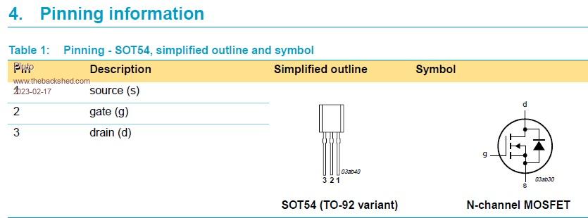

The MOSFETs for the keyboard (Design #2) was to have used BST72A (two).
Various others seem OK, but are the source, gate, drain sometimes in the reverse order?
E.g. 2N7000, TN0702N3-G, VN0808L-G, VN10KN3-G all seem the same but opposite of BST72A.
(I've not found a convincing pinout for the BST72A, though.)

I found the BST72A datasheet unclear & its pics unhelpful/unclear (e.g. no indication of the viewpoint). All the others were clear, with clear pics. Sadly that didn't help me compare because of the BST72A's pics etc.
It did seem likely the pin order is reversed, but that in itself felt mad!! I mean, WTF!

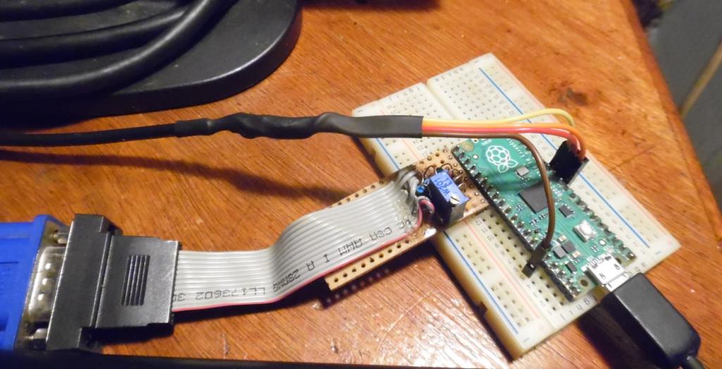

Why not the inverter I suggested for non pcb. I use an 8 channel one for spi glcd on pics. They work and are neat and cheap.

I got that it's a pcb design. The pcbs I've used take those header pin size no problem.
I use breadboard as it's quick and cheap and not permanent. looks a mess for glcd spi but neat for vga and fits in with my thoughts that picomite is a hobbyist idea that you can try cheaply to see if you like it.
You'd learn more wiring it on breadboard.
There was a video https://www.youtube.com/watch?v=kZaWYgIYgd8&t=1019s published on the forum which I thought was not a way to get a new user to use vga picomite... would take ages but a breadboard with the 4 resistor vga circuit would take minutes...
ok a ps2 kb you should just happen to have and a vga monitor/tv but you get the idea of hobby/fun. If you don't like it then you haven't invested much. I think the idea is you have all the bits except the rpipico.

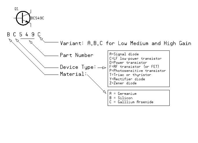

Europe adopted a standard for semiconductor parts naming that was based on a pre-existing Philips standard used for vacuum tubes. These parts became known as the Pro Electron/EECAdesignation which was created in the mid 1960s. It used a much more informative prefix and suffix than the JEDEC standard used (JEDEC is where 1N for diodes and 2N for BJTs came from). Here is an example:
Interestingly, pretty much every 'BC' part has a flipped layout from JEDEC pinouts, and Japanese parts also tend to have a different layout than JEDEC parts.  It's almost as if they are forcing you to *use their replacement parts* if your PCB was designed for them in the first place.
