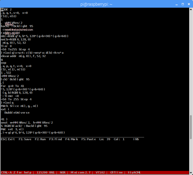

I have a problem when using the editor in mode 1.
If I change to Mode 1 and then Edit, the editor only shows some of the lines of the program and locks up solid, requiring a power off reset.
PicoMiteVGA MMBasic Version 5.07.07b19
OPTION SYSTEM I2C GP22,GP15
OPTION COLOURCODE ON
OPTION KEYBOARD UK
OPTION DEFAULT MODE 2
OPTION DISPLAY 30, 53
OPTION SDCARD GP5, GP2, GP3, GP4
OPTION AUDIO GP6,GP7, ON PWM CHANNEL 3
OPTION RTC AUTO ENABLE
OPTION DEFAULT FONT 7, 1
I have now found that it's the OPTION DEFAULT MODE 2 that is causing this, if I change it to OPTION DEFAULT MODE 1 all seems to be ok.
Edited 2023-02-17 05:40 by Bleep
Bleep
Joined: 09/01/2022
Posts: 867
Posted: 08:00pm 16 Feb 2023
Also, I accidentally copied and pasted all of this piece of code, using autosave.
vgabubble.bas.zip
I realise it's several slightly different versions of the same code, however once loaded the editor mangles it, the first 35 lines of code are fine and consist of a loop so the rest is never executed. However I didn't think the remainder should get corrupted like this, even though it shouldn't be there? the image is after scrolling down one page. I had done a flash erase and fresh install of b19 with no options set this is a terminal, but the VGA looks the same. This isn't particularly important as I shouldn't have done it! :-(
Any Ideas?
Regards, Kevin.
