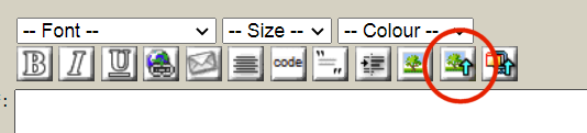

I am a newbe! Can someone please advise me how to add a JPG image to a posting?

Above the text entry field there are icons. Select the green one with the blue arrow in it.
A popup lets you select the file.

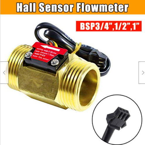

Using a water flow sensor would be a lot easier than monitoring the current.
I used to use the ones from Jaycar but found that they only lasted a couple of years.
I currently use these:
https://www.ebay.com.au/itm/304598403631
I have 4, monitoring house water, garden, stock and bore.
Whatever you do, don't use it to measure the amount of water your wife uses in the shower.
A plumbing leak would be the least of your worries.
You can use Arlec remote switches for the AC control but they are a bit under sized for motor starts. (I do use one for the bore pump and it has lasted many years so far.)
