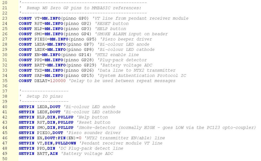

Hello all.
Trying to set GP0 as an input, but MMBASIC throws an error:
SetPin 0,DIN
Error :  Pin 0/NULL is reserved on startup.
OK, fair enough.
Use this instead:
SetPin GP0,DIN
That works fine.
I normally use CONST to define the pin numbers with useful names for inside the code, such as CONST DOOR=05, WINDOW=06 - that kind of thing, then you setup the pins using the constants: SetPin DOOR,DIN and SetPin WINDOW,DIN kind of arrangement.
It would seem this is NOT permitted on the PicoMite if you use the GP references.
Is that correct or am I doing something wrong?
If I try to do the above but replacing the numbers with GP references such as CONST DOOR=GP5, when run, the interpreter does NOT like that.
Error : GP5 is not declared
Am I correct that if I use the GP references, I have to just use them throughout the code and not have easy to remember versions?  I think that might be the case....
Another example is if I try to use pin-numbers and CONST, the interpreter does not like that much either for certain pins.  Take GP8.  If I try to CONST DOOR=8, and then SetPin DOOR, DIN then that generates an error: Pin 8/GND is invalid.
I'm using a WS Zero module, so do I have to simply remap the pins from it, to match the standard Pico module, then I could perhaps use the pin references.
IE: Define GP0-GP29 as CONST, along the lines of CONST GP0=0,GP1=1,GP2=4... GP6=9,GP7=10,GP8=11....
THEN use SetPin GP8,DIN, which will in effect be SetPin 11,DIN if you see what I am getting at.
Does that make any kind of sense, or is it all clear as mud?
EDIT: I've just tried that out, and it works, so I have my answer.
I'll leave the thread up for anyone to comment on though.

> const mypin=mm.info(pinno gp15) : ? mypin
20
or
> const gp14=mm.info(pinno gp14) : ? gp14
19
> setpin gp14,din
"MM.INFO$(PINNO GPnn)
Returns the physical pin number for a given GP number. GPnn can be an
unquoted string (GP01), a string literal(“GP01”) or a string variable. Ie,
A$=”GP01”: MM.INFO(PINNO A$)"
Edited 2023-02-13 11:05 by phil99

Posted: 12:55am 13 Feb 2023
Bloody perfect!
Thanks - that's even better then my hack-it-up attempt.

Using phil99's prod and mm.info is working PERFECTLY, and I don't even have to think about remapping pins, cos that idea does it all for me.  MM.INFO contains a rather large subset of useful bits of information you can return by using it, but that means I had completely forgotten about the one Phil reminded me about.
  JohnS said  A mistaken edit / change of mind such as:
const gp14=mm.info(pinno gp13)
setpin gp14,din
Could be confusing...
Agreed.
But as I always refer to pins by setting constants and giving them names, SO LONG as you don't mix-and-match named pins with the GP pin references, there SHOULD be minimal risk of getting confused.
In other words, pick one or the other but not both.  Use GP references or pin labels but not both.
I like to use labels for all my pins, cos it is MUCH easier to remember what the line of code is doing on a given pin, if you have a pin called PIEZO for example - it has to be the piezo buzzer driver etc.
