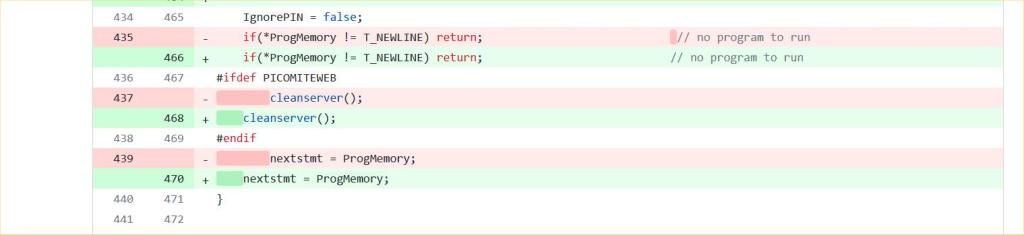

This is why I absolutely despise this approach and there is no way I would ever do an automatic update

  matherp said  This is why I absolutely despise this approach and there is no way I would ever do an automatic update.
Thanks Peter I'll check it out later ... though I'm not sure what your comment is regarding, as far as I'm concerned the screen-shot clearly shows that in that small section of code I updated the whitespace for consistency (there was a mix of spaces and tabs which I converted to spaces) and one of the comments had strayed a space from alignment with the others in the file so I fixed it.

Posted: 10:52pm 21 Feb 2023
If you had posted the complete files I could have done the change in 50% of the time and with less chance of error using winmerge - and I would have done it days ago rather than putting it off

  matherp said  If you had posted the complete files I could have done the change in 50% of the time and with less chance of error using winmerge - and I would have done it days ago rather than putting it off
  thwill said  If you want me to provide them by some other means then please let me know.
Plus if you follow the link supplied, at the top of each file/section on the RHS there is a [...] button, click that and select "View file".
Anyway we got there in the end, thank you, I'll drop you an email with some further comments.
