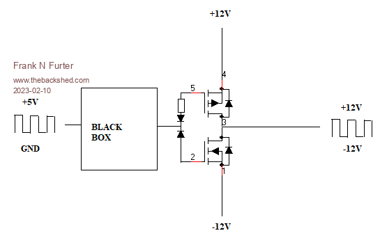

I have a +5V/GND square wave voltage which I want to convert to a +/-12V square wave voltage using two mosfets.
My attempts under LTspice to control the mosfets with transistors have not worked so far - can anyone help me?

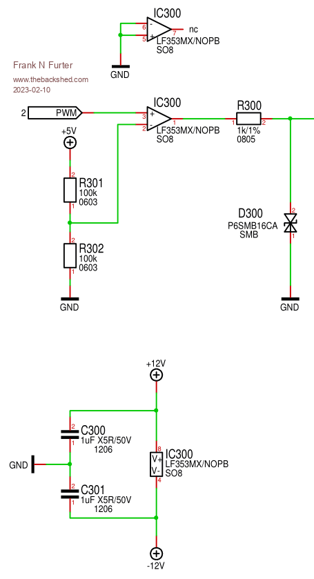

thanks for your response!
At the moment it is solved via an operational amplifier. Unfortunately, this does not work rail-to-rail and suitable operational amplifiers are currently not readily available (and/or very expensive). However, voltages as close as possible to + and - 12V are needed.
The space on the board is also very limited!
Only a maximum of +/- 12mA at 1 kHz switching frequency is required. There is also a state where +12V are output continuously instead of switching (this is the OFF state).

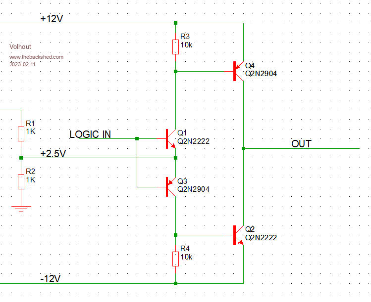

Posts: 6204
Posted: 11:28am 10 Feb 2023
  matherp said  LM393B ?

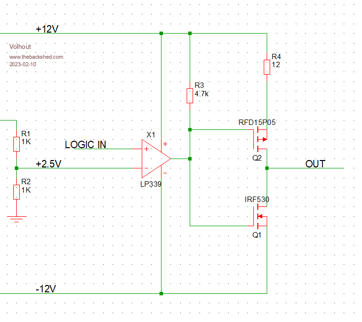

The 1kHz can be handled by a comparator. If you use a LM393 it will sink below 1V to switch off the -12V N-channel FET. It needs a pullup to reach the +12V. With 6mA sink capability, you can go as low as (12+12)/0.006=4k ohm. I used 4.7k
This is a very simpel circuit. Since there is a moment in time where both FET's are conducting (when the output if the comparator is between -7V and +7V) there will be peak current in the FET's and power supply. To limit this current the 12 ohm resistor is added.
Be aware that this circuit drives the gates between 0V an (12+12)V. So you need to use FET's that can handle 30V as Vgs. Also for the P-FET.
The comparator input compares the LOGIC IN signal with 2.5V. That is half the voltage of the 5V.
P.S. the circuit can be enhanced and tuned by using the other half of the LM393 dual comparator and an externa transistor. But that may not be needed.

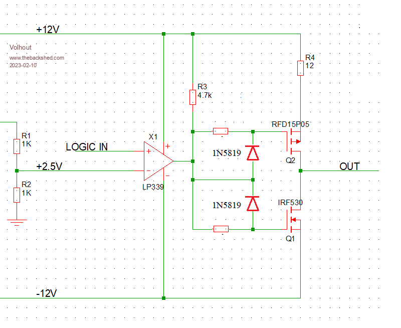

Adding to Volhout's circuit switch-on delays to reduce the need for R4.
The values of the resistors will depend on the gate capacitance and the required delay, which should be slightly longer than the switch off time. I guess the circuit simulator can work it out.

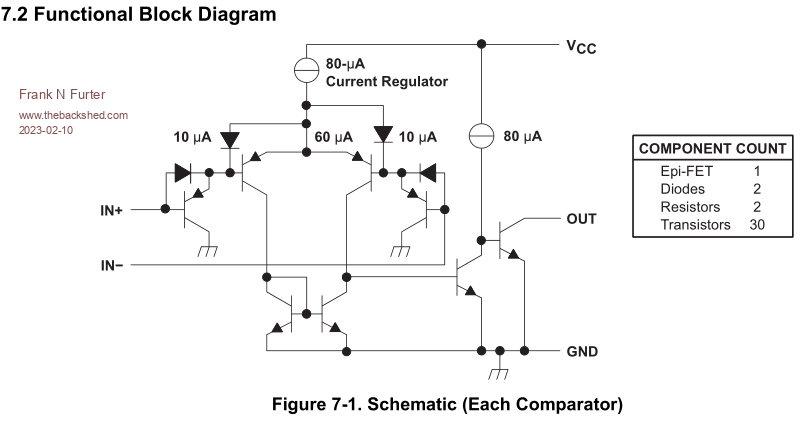

Hmm, this looks very similar to the current realization:
Unfortunately I don't have room to put the LM393B and the mosfets.
Is there no possibility to do without the LM393B and to realize it with transistors?
Internally, it is also only set up as an open collector:
Frank

The LF353 is a poor choice. At +/-12V the output can go from +10V to -10V. It may not turn off the FET completely. It is fast though (for an OPAMP).

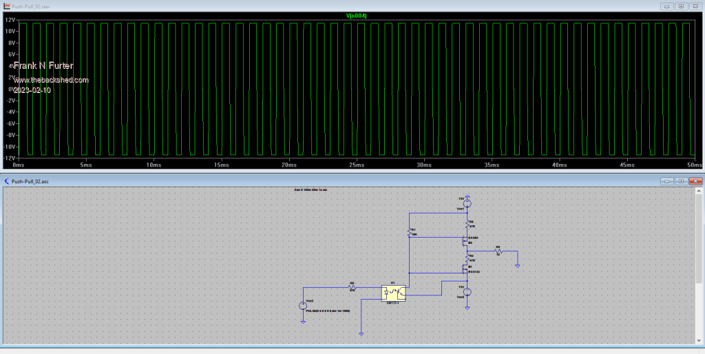

The LF353 IS currently the operational amplifier - it generates a signal from about +11.4V to -10.4V (WITHOUT additional mosfets). I would need a bit more voltage in the negative range...
@Mixtel90:
I had just tried that with the opto. In the simulation it seems to work - I would have in any case no place for it!

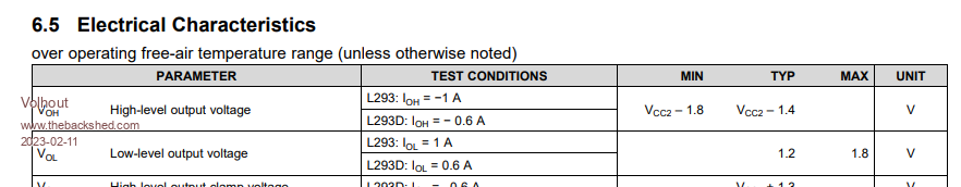

Posts: 6204
Posted: 03:37pm 10 Feb 2023
The L293 is far worse than the current LF353 opamp.
The outputs cannot drive rail to rail, and since you have a bridge (using 2 outputs) the problem doubles.

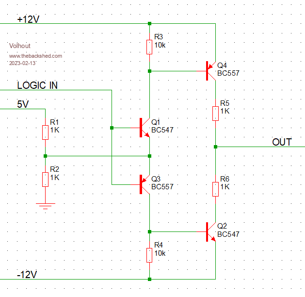

Posts: 6204
Posted: 03:44pm 10 Feb 2023
What about some classic bipolar junction transistor fun...
This is super simple, super cheap, but may require board area you do not have...
Although in SMT parts (dual transistors in SOT23-6) and small 0603 resistors...
No FET's, just use the transistors to drive the 12mA
This will work with 5V and also with 3.3V....
As long as you keep the resistors 1k and 10k
Edited 2023-02-11 01:52 by Volhout

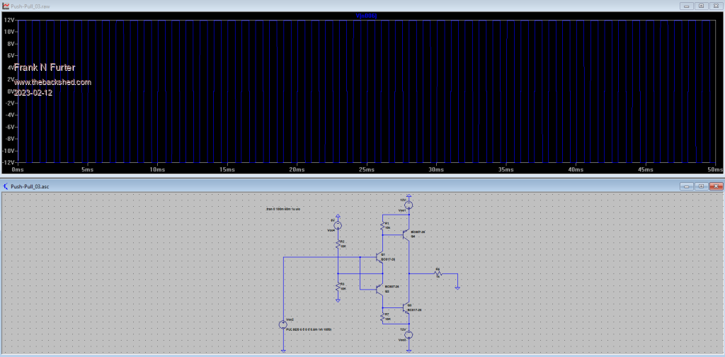

This is a very interesting circuit, thank you! However, in the simulation I achieve only a little less than -10V and about +11V.
I tried it with BC807 an BC817...
Frank
Posts: 6204
Posted: 09:09pm 10 Feb 2023
Hi Frank,
Please use BC557 and BC547. The BC807 and BC817 are darlingtons, and do not work well in this circuit.
Or use:
NPN: BC548, BC549, BC550, BC337
PNP: BC558, BC559, BC560, BC327
Succes

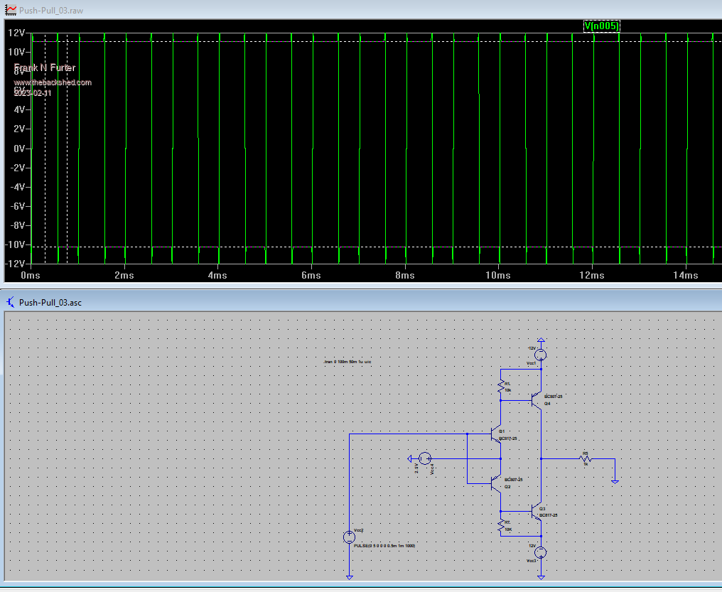

In your simulation of Volhout's circuit you have omitted the source resistance of the 2V5 supply (1k / 2 = 500R). that is important as it sets the base current for the output transistors. My experience with similar circuits suggests you should get within 0.3V of the 12V rails.
Edit
PN100 / PN200 transistors have a Vce(sat) of 150mV @ Ic = 100mA
or  Vce(sat) of under 50mV @ Ic = 10mA
Should give you 11.94V or better at 12mA.
Edited 2023-02-11 09:13 by phil99
Frank N. Furter
Joined: 28/05/2012
Posts: 1162
Posted: 03:25pm 11 Feb 2023
@Volhout:
Darlingtons??? The BC807 is the SMD form of BC327 and the BC817 of BC337...
(the selection of transistors is unfortunately very limited in my program...)
@phil99:
THAT'S IT!!! YOU ARE RIGHT! For simplicity I just took a voltage source with 2,5V - if I put a voltage divider to 5V it works!!!!
Thank you both so much!!!
