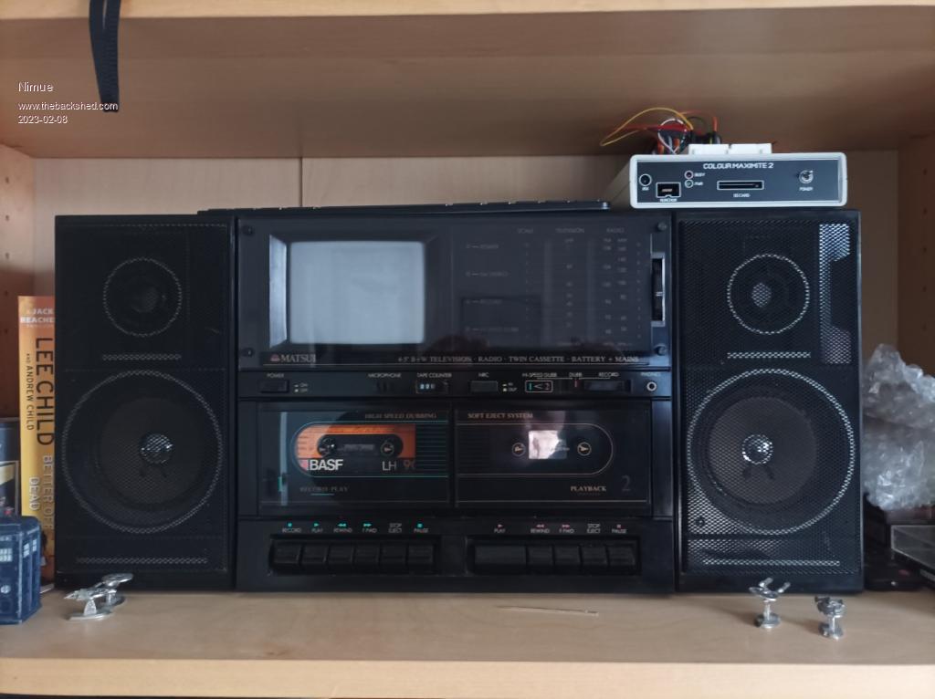

How much geek in one photo ;-)
N
Posts: 9258
Posted: 04:59pm 07 Feb 2023
That is true geekery in all its beauty. :)
I've not seen one of those Matsui boxes for ages.

Posted: 05:28pm 07 Feb 2023
  Mixtel90 said  That is true geekery in all its beauty. :)
Not shown but the RF in is a great match for my Zeddy and Speccy.  B&W of course!
Another rabbit hole for the weeked.
N
Posts: 9258
Posted: 05:35pm 07 Feb 2023
I really approve of the little Tardis too. :)
