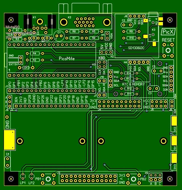

Born out of frustration. :)
Of course, it's 100mm x 100mm.

Cool, I might have a go at building one.
Note in order for the 3.3v switch mode chip to be disabled and its output substituted by an analog PSU, by taking its 3.3_EN input low, it has to have power on the VSYS input pin, so the chip is active and can respond to the low on the 3.3_EN line.
Mike
Posts: 9257
Posted: 08:32am 01 Feb 2023
It normally would have as the 5V supply would be via the USB input. VSYS is fed from VBUS via an on-board diode. The Ext 5V input does the same thing. It's not visible in that pic as I switched off the bottom copper layer to make it prettier. :)

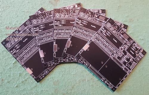

JLCPCB came up with the goods this morning, so a new toy to play with soon. :)  Dry assembly has been ok so far, which is a good thing. I have some bits (including the breadboards) on order. The jack socket is going to have to wait until I can make up a sensible order from RS.

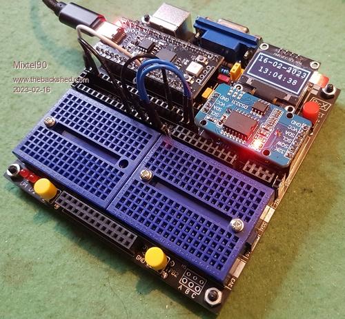

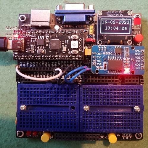

Laydees an' Gennelmen! We have a prototype for your delectation!
Please excuse the flux grunge - I've no flux remover and isopropyl alcohol makes the board sticky.
If you need more breadboard area you can expand it at the right-hand end, just directly outwards or with more breadboards above and/or below the first one.
This is also a pretty good illustration of why you should avoid black or blue breadboards - the holes are harder to see. :)
Incidentally, the two blue Dupont leads are connecting the I2C bus to the PicoMite (a YD-RP2040).
Not tested with VGA and PS/2 yet.
