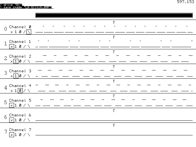

Hi All,
As suggested by Peter, the logic analyzer project get's a new thread.
Pluto: maybe this is of interest to you. PAN and SCAN (zoom and scoll) is working on the cursor keys. The trigger indication is not yet live, but you can set the trigger typing "t". Changing the sampling rate under UI control is next.
Current focus is on:
1/ faster plotting
2/ trigger jitter
'|     logic analyzer framework research program      |
'| Volhout                                 20-1-2023  |
'samples GP0...GP15 with triggering on GP22

Sub set_screen
 MODE 1:Colour 0,RGB(WHITE):CLS :Font 7
 Local f%,i%
 Dim a$(2)=("x","1","0")
 Dim tr(7)=(0,0,1,1,2,0,0,0)
'text
 For f%=0 To 7
   Font 2:Print @(0,84+48*f%); f%
   Font 1:Print @(30,84+48*f%); "Channel";f%
'color
   TILE 0,5+f%*3,0,RGB(WHITE),7,2:TILE 7,5+f%*3,0,RGB(yellow),33,2
   TILE 0,4+f%*3,0,RGB(midgreen),40,1
   Line 0,64+f%*48,640,64+f%*48
'trigger boxes
   For i%=0 To 2
     If tr(f%)=i% Then
       Box 34+i%*14,96+48*f%,16,16
'trigger text
     Print @(38+i%*14,98+48*f%) a$(i%)
   Next i%
 Next

Posts: 12058
Posted: 12:31pm 27 Jan 2023
I would suggest trigger at 10% or even better changeable
Posts: 6197
Posted: 12:41pm 27 Jan 2023
  matherp said  I would suggest trigger at 10% or even better changeable
Yes, can do. The code has a variable posttrigger% for that that is currently set to 50% default (sometimes you want to see what is causing trigger, sometimes you want to see result of trigger). Not sure if posttrigger% is implemented in all routines. I may have been cutting corners at places... But end goal is to have it configurable.
P.S. with current array sizes (4096 samples), I cannot use framebuffer (despite 44k free, the 38k frame buffer does not fit). Need to check why. Should fit.
Edited 2023-01-27 22:44 by Volhout
Posts: 12058
Posted: 12:51pm 27 Jan 2023
The code setting up the ringbuffer has to align it to a memory boundary that matches its size (limitation of the silicon). You need to assign it at an appropriate time relative to other variables/framebuffers to minimize the memory usage. Trial and error and peeking varaddr is the best approach I can suggest
Posts: 6197
Posted: 09:20am 28 Jan 2023
Intermediate version
comment "generate_test_signal" out and you have a 6/8 channel LA
on VGA you may want to disconnect and disable audio for channel 6 and 7
cleanup of code must happen
trigger must be extended with edge trigger
change:
pan/scan with arrow cluster
sampling rate with +/-
trigger with t
enjoy

Posts: 3416
Posted: 11:42am 28 Jan 2023
Thanks Volhout this will be very useful.
Displayed pulse widths seem to fluctuate a bit.
Posts: 6197
Posted: 01:42pm 28 Jan 2023
In this version, the display shows all samples when you zoom in maximum. When your sampling rate is 10kHz (100us) a signal of 120us can appear as 1 sample, 100us, or as 2 samples 200us. Depending on the exact moment of the first sample. To minimize this effect the trigger program runs fastest.
This effect will be less if you sample faster (press + key few times.)
When you zoom out, you will start seeing aliasing effects, since the display will show 1 in 4 or 1 in 8 samples. The LA samples 4096 samples, but shows only 128 or 256 at a time.
I hope this explains a bit...
P.s. if you have optio audio set, channel 6 and 7 will show aliasing signal of 44kHz. Only when you turn the samping up to 1MHz it makes any sense. At the moment you can not trigger on channel 6 and 7.
Edited 2023-01-28 23:50 by Volhout

This is version 0.12 of the logic analyzer.
It is a major re-write of the trigger engine. I have to put it through it's paces, but think it is functional enough.
From here I hope the changes will be cosmetic.
User interface:
arrow keys zoom in and out, and move the visible window through the buffer
with +/- you increase/decrease the sampling rate
setting the trigger is still typing in a string of characters.
Default setting now is for 8 channels, but you can change the value of maxh_chan_no% in line 25 (5=GP5, 7=GP7).
todo:
- trigger changes
- nice top of screen graphics
- programmable channel names
future:
- I2C decoder, SPI decoder, UART decoder

Posts: 6197
Posted: 03:54pm 31 Jan 2023
LA13.zip
Hi Pluto,
I have taken your code and will paste it into the logic analyzer. When there is anything you are working on to improve, just let me know. I have done what you suggest, and pasted it in the logic analyzer.
My target is to print the decoded text (start/stop/read address/R/W) in the green bar above the waveform at the location where it is in the serial stream.
In my logic analyzer (I progressed to version 0.13) I have edge trigger implemented and single trigger. It is not yet finished, but do you want it to base the decoder on , I can post a zip.
I very much like this way of working together. DMA from Peter, graphics from Martin, I2C decoder from you, PIO engine from me.... A true community project.
User interface:
+/- to adapt sampling rate
s = single trigger
r=repeated trigger (run)
0...6 toggle through trigger options for that particular channel.
It may not be stable, please provide feedback.
P.S. it is default 6 channel now
known bug: when the DMA times out (at 21MSps this is after 2 minutes) and you press a key, you get an error message and the program stops. If you are running 500kSps, this happens after 1 hour waiting for a trigger.
