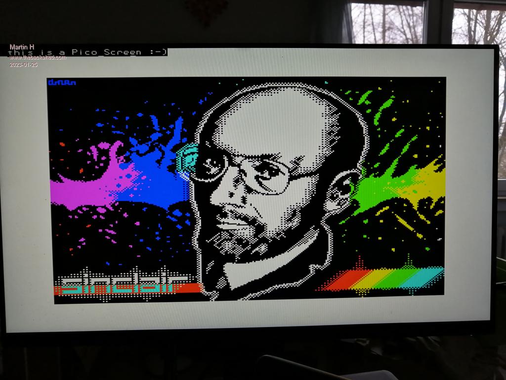

I've made a little Tool to show ZX Spectrum Screen$ files on the Pico
Missing: Flash Attribut and Brightness for white.
'ZX Spectrum Screen Loader for PicoMite

to keep things easier, I used Mode 1 and the Tile Command for the Colors.
The disadvantage of this is that you cannot save the image with Colors as a BMP File.
here the Sample Picture

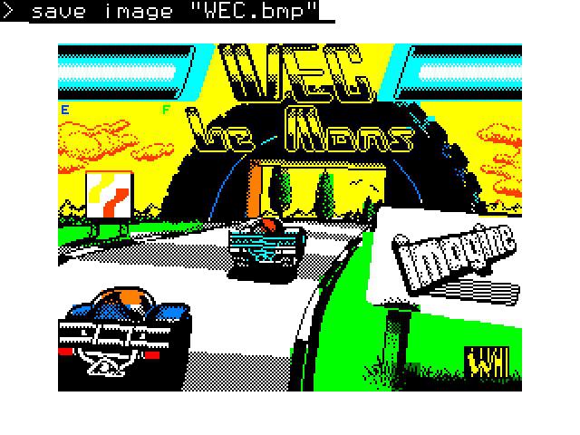

but.. wec.scr    6912 Bytes
     WEC.bmp  230454 Bytes
so the bmp file is 33.3 times as large as the source

The Pico can allready Save BMP with the Save Image Command, but it uses 24Bit BMP, thats why every Pixel needs 3Bytes. As alternative we can also Load JPG Files.
