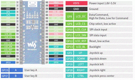

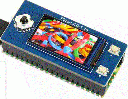

I have one of these boards and would like to know if it will be possible to use it on the Picomite
Waveshare 1.14" LCD 240X135
Website says it uses an ST7789 Driver
https://www.waveshare.com/pico-lcd-1.14.htm
Has anyone managed to use one of these with the Picomite? If so could you share your OPTION SYSTEM SPI and OPTION LCD PANEL settings.
It looks like there are some Pin conflicts, so is there a way to get around this?
The  Picomite Pin out diagram in the manual (pg. 9) shows Pins 31, 32 and 34 as being " SP2" pins, is this an error and they should be SPI2?
Posted: 07:50am 16 Jan 2023

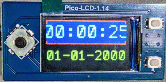

Try
OPTION SYSTEM SPI GP10,GP11,GP28
OPTION LCDPANEL ST7789_135,L,GP8,GP12,GP9,GP13

  Glen0 said  The  Picomite Pin out diagram in the manual (pg. 9) shows Pins 31, 32 and 34 as being " SP2" pins, is this an error and they should be SPI2?
Good catch - yes, I think so.
Yes it is and thanks, I will fix in the next release.
